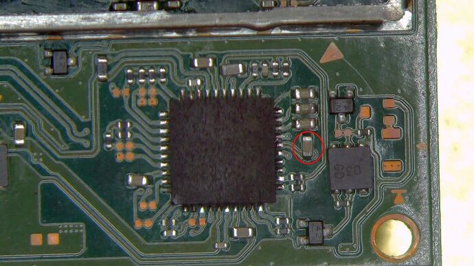

Hi guys! Got an issue with a Nintendo Switch. Not turning on or charging. I found 3 shorts by M92 so I replaced it. well 1 short remained so I replaced it again and short in same place. I injected voltage and only the M92 got hot so I replaced ic again with one from another batch and again same place is a short. Remove the ic and short is gone.(see pic) I have not found any other shorts. Anybody have any ideas? TIA!

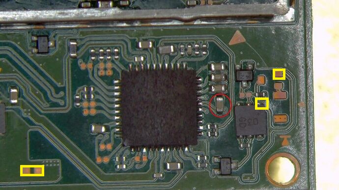

This is an voltage supply line VCONN_IN and is connected to the double mosfet on the right. The mosfet switches the power from the top right pin. I would check if this line is shorted.
Will do! Thank you for the help.
