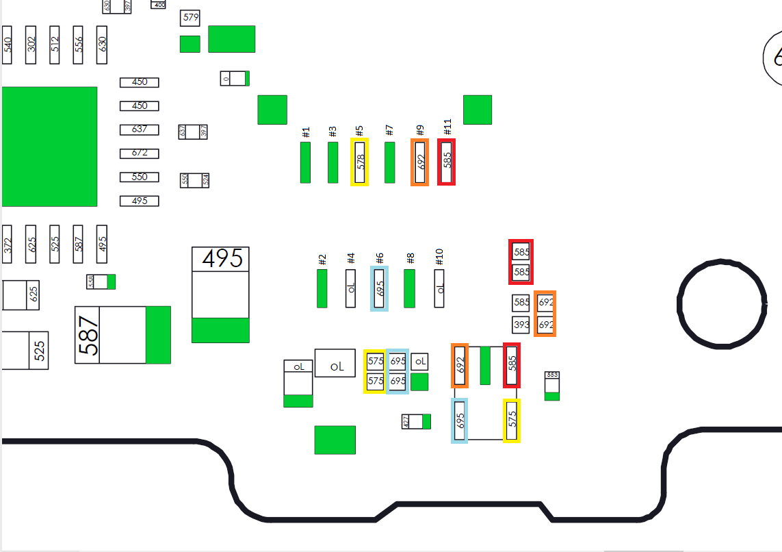

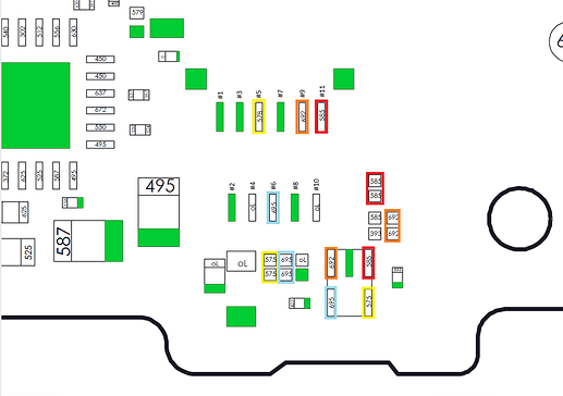

Maybe this could help:
The values are mV in diode mode. (No powersupply, no battery, red probe on ground and with the black probe on the pins/pads)
JoyCon_l_Volts
