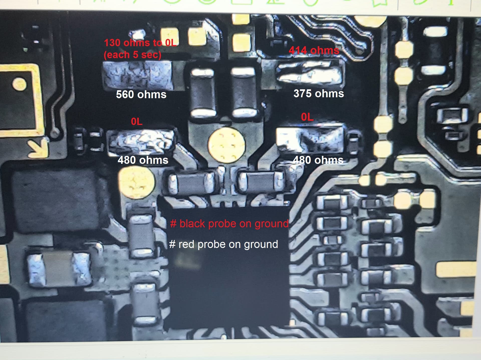

See result here
Resistance to ground for P13 and M92 pin 6 seems good and stabe.

Ufortunately as epected the fault seems to be pointing towrds the SoC…you can try doing the same thing on the coil on your 1VPDR and see if it suggests the same if you want…
Near the Realtek IC if you don’t know what I’m talking about just measure off the big cap near middle of the P13 instead which is on the same rail
You mean this one ?
The cap in the middle of P13 show:
Any suggest ! Thx
yeah. Which probe on ground?
It’s low but need confirmation on the above prior (notice the similarity)
The coil 1VPDR resistance is 425 ohms case black prob on ground and stabe.
For P13 show the 425 ohms case red prob on ground
Interesting they’re correlating so closely (even on inverse polarity) … I don’t think this is a coincidence
With one probe on one and the other probe on the other whats the resistance?
Black probe on p13 cap and red probe on P1VPDR 830 ohm
Thr opposite show 1070 ohms.
Note that the mesurement on the PMIC coils was made by using black probe on ground as you recomand
Interesting, divisible by two and we end up at the approx resistance of each which makes sense…
Remove this inductor the same as the other and see which side the high short remains on. You migt also want to disconnect the EMMC module as this is also connected to this rail.
Unfortuunately though the only ICs which have these two rails in common (afaik) is the SoC and the PMIC, based on your previous results it’s looking more likely to be SoC related fault.
Yes unfortunately based on your measurments it’s almost certanly an SoC related issue, most likely being caused by an internal short to ground on your 3V3PDR and pulling down those other rails as a result, as such there isn’t really much you can do

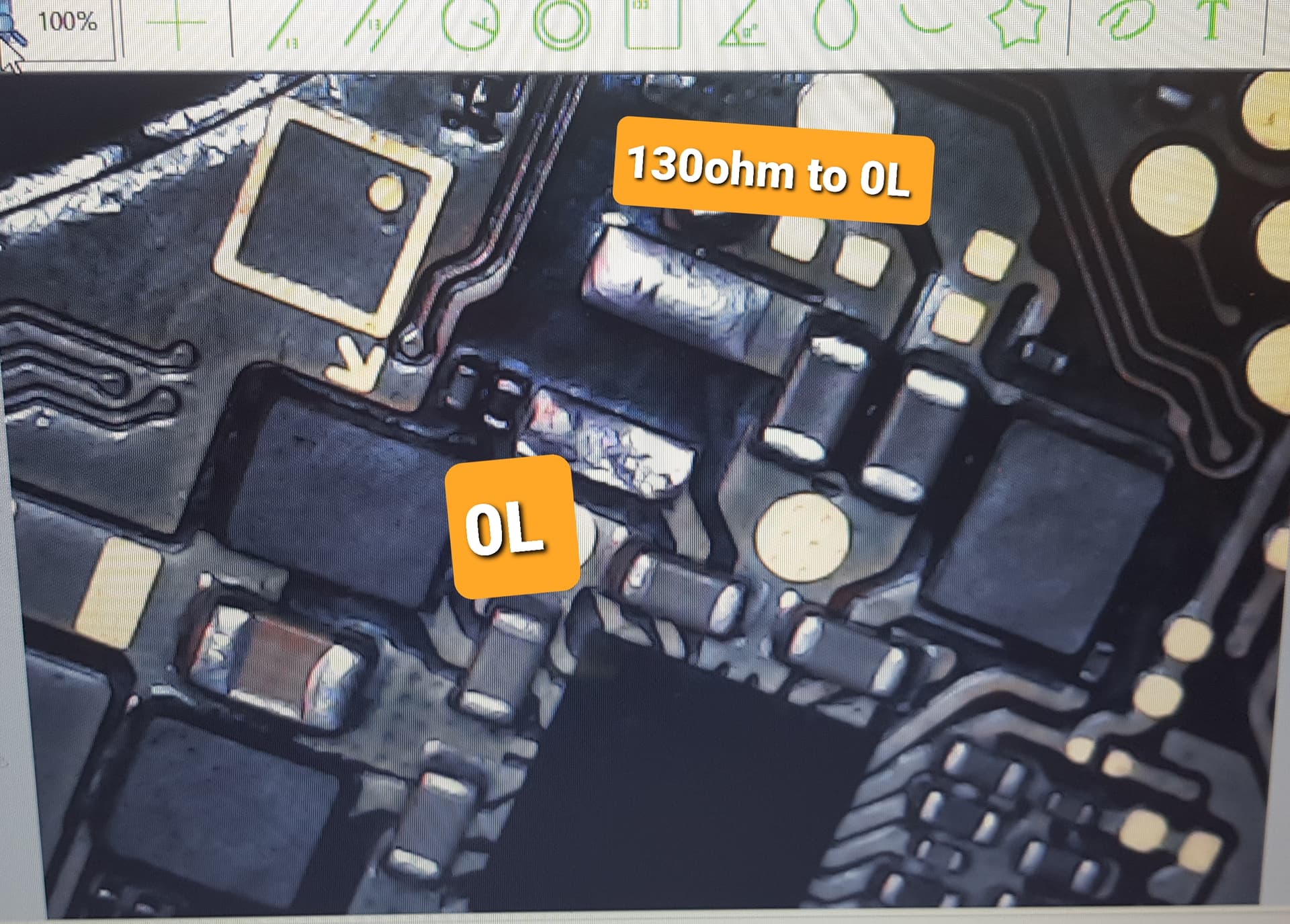

Certainly it is more complicated. (Recall, the switch starts well, it freezes but responds every 5 seconds, still show battery drain)
recalls intervention history in the order USB-C, MT92T36, max17050 then I changed the P13 and also the screen connectors and the touch pad. This short circuit may have occurred following a Mishandling.
Unfortunately it seems so, I mean you can pull the PMIC as a last crossed finger approach but I expect the shorts to remain even after ![]()
