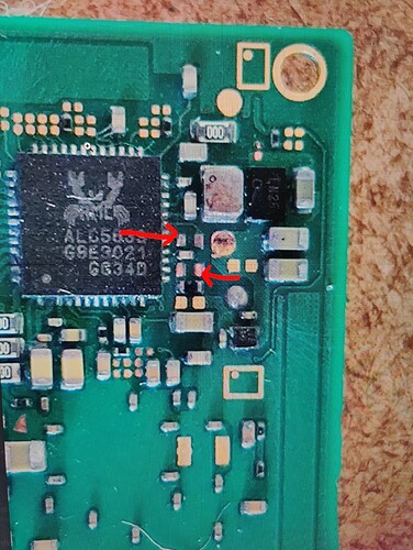

2 resistor/caps are missing near the audio chip. Does anyone have an idea of which ones they are?

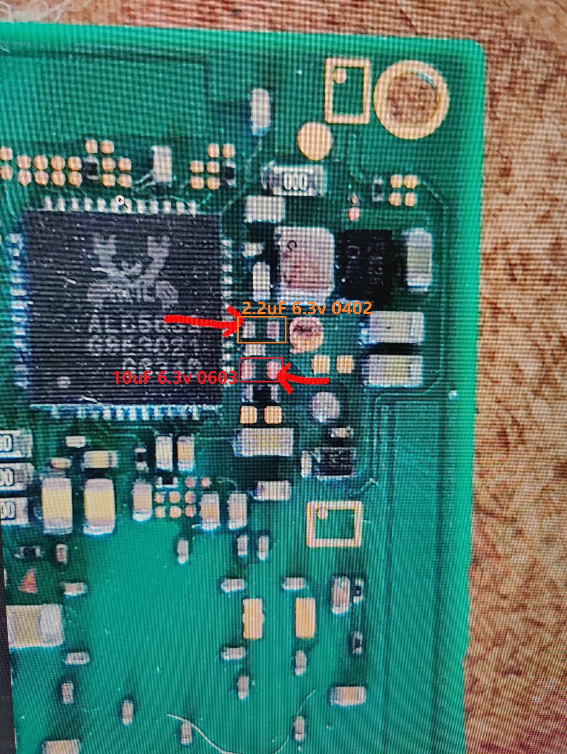

So they are 2 capacitors. The left one is the same size as the horizontal capacitor directly to it’s left and the right missing capacitor is the same size as the vertical capacitor next to the 000 resistor to the left of the missing caps.
As for it’s value I really couldn’t tell you as you can’t measure them with just a multimeter and get an accurate reading. However if you can source a donor board for the switch you’ll be fine to take the same caps off or any caps of the same size from the board and chances are it’ll be fine. Particularly within the same area if possible.
