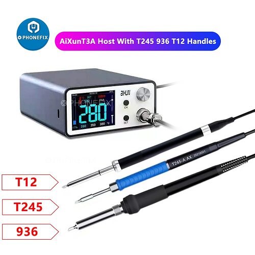

An alternative would be the following
I saw a review of this station by SDG and it looks quality, though a few key points, I don’t think it allows for independent tip calibration and profiles like the KSGER does (just a global calibration) which is a negative, the UI is pretty simplistic… on the other hand they are utilising the metal ring on the handle and a fly lead from the station to the cradle to initiate sleep like a JBC which is nice. I’d go with the T12 version myself, which is in contrast to SDG opinion that the JBC style are better… I got a JBC handle and tips and in my experience they performed worse than T12 tips (despite being almost twice the power) as the tips didn’t last as long (one lost it’s coating inside of a month after very little use) and the tip price, clone or real is significantly more expensive.
There are many, many more stations which might be better choices or might even be cheaper but these are the two that spring to mind atm :smiley:
