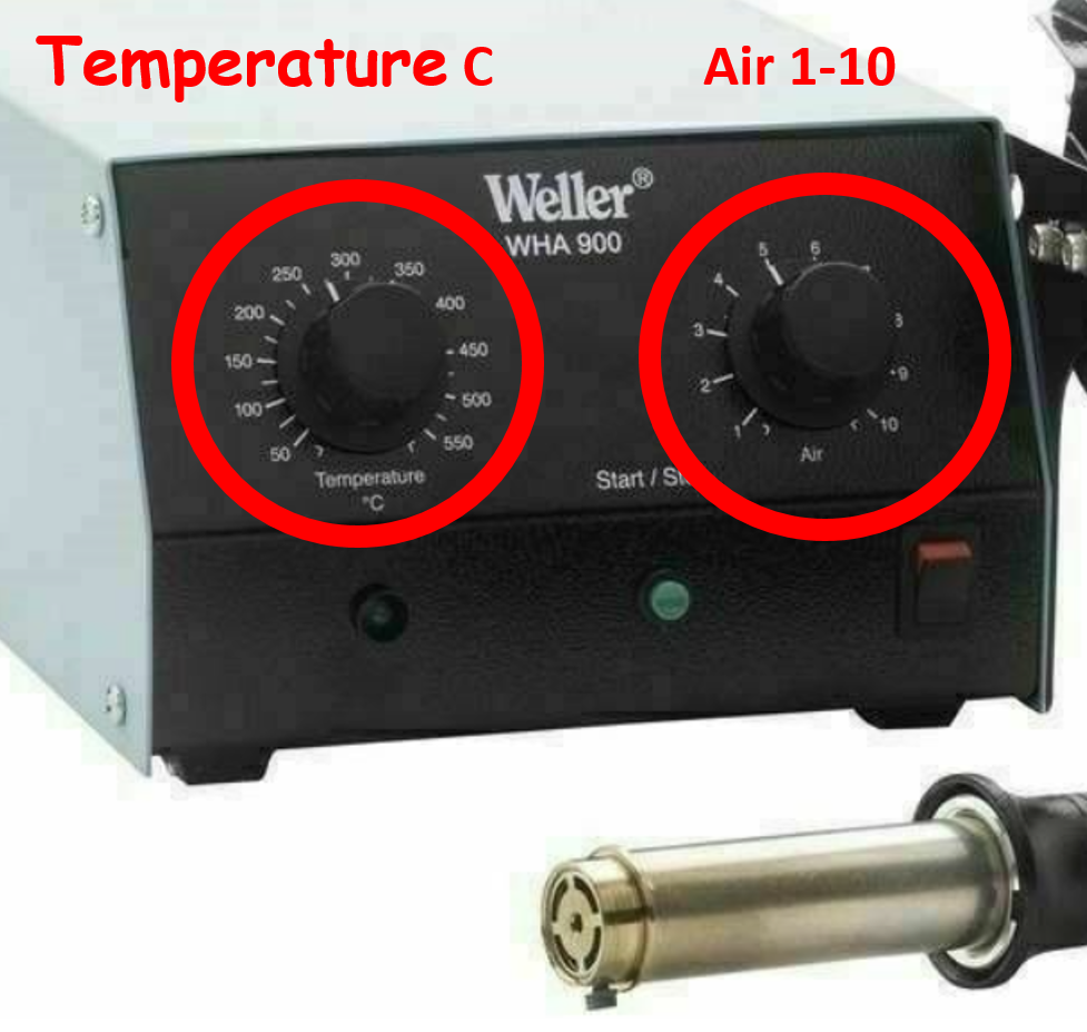

I wanted to know what setting and nozzle to use on my Hot Air station for removing HDMI ports?
I have a Weller 900 and I am having trouble removing ports. I can do it but it takes at minimum 10 minutes and I have an even tougher time removing the solder from the holes.
So, where should I place the dials on my station?
Hey Chicago, I have found being on the hotter side to be better. You’ll want to take your temp to atleast 500C if not a little bit more. Otherwise it will take absolutely a long time. Airflow usually can stay around 3-4. Try that out!
Awesome, thanks for the suggestion.
I usually just put both all the way up, but I was told that the air should come down.
