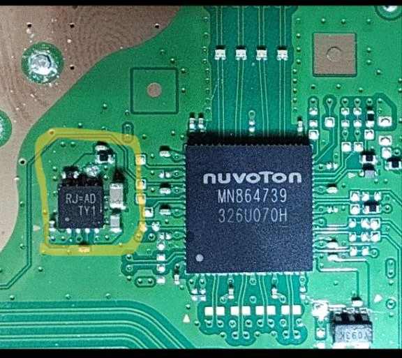

Hi, I'm having trouble starting my PS5 Slim and I've found the problem is with the IC that powers the HDMI port; it's not outputting any voltage. The input is 5V, but there's no output. I think the IC is broken. The problem is, I don't know the model number so I can buy a replacement. I've seen that it's the same as the one in the PS5 Fat, but I haven't found the part number. Does anyone know which one it is so I can buy it? Thanks a lot.
https://www.reddit.com/r/consolerepair/comments/1fy4mdv/need_ic_ps5_slim_rjaf_wy3/
This one kasynparts..com/product/ps5-edm-020-board-rj8g-chip-ic-ldo-1-5a-low-dropout-wdfn-8
