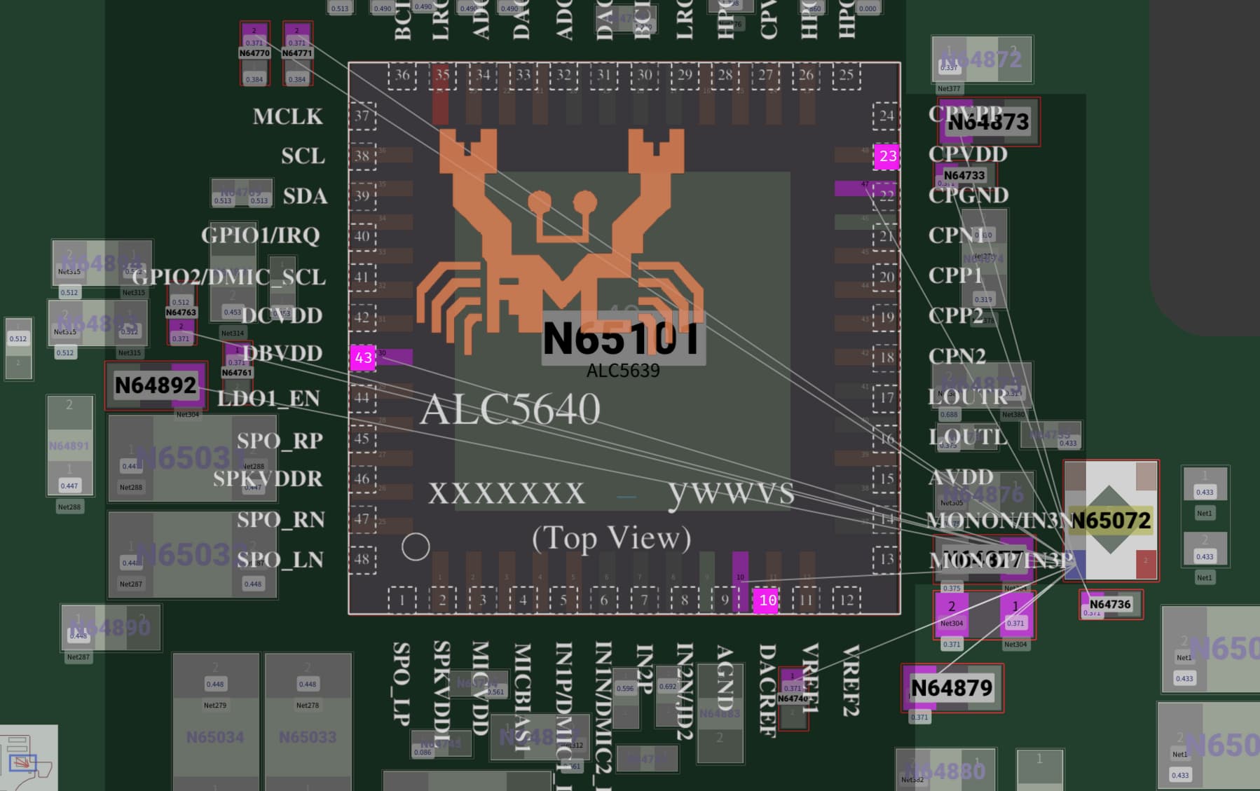

I need help identifying what component this is. The marking on the chip is L18. I cant seem to find anything online about this. Attached is a picture of the component I need help with. Chip is near the ALC5639 Chip.

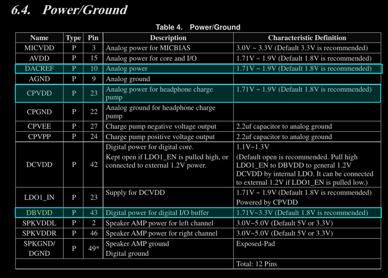

I’m fairly certain it’s a voltage regulator/LDO that supplies 1.8v to the ALC5639’s DACREF, CPVDD, and DBVDD pins.
DACREF is analog power, CPVDD powers the headphone charge pump, and DBVDD is digital power, all of which expect 1.8v (ideally).
150mA should suffice, but there shouldn’t be anything wrong with using one rated for 300mA as long as it’s outputting 1.8v. Being rated for higher is fine, as the switch will only draw what it needs (assuming no other board faults of course).
