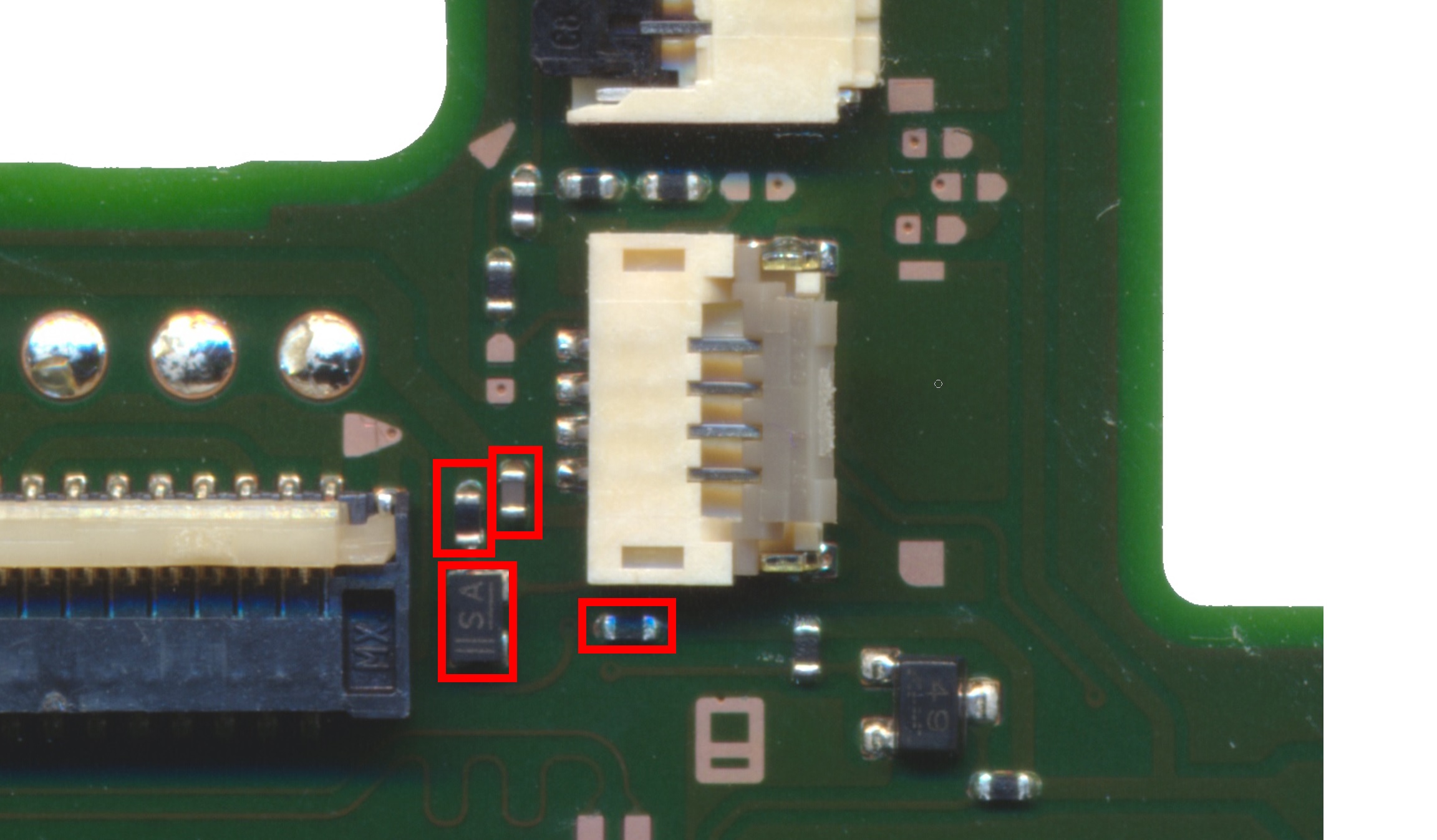

Hi,
Can someone help me find the value of those components near the LCD connector
Thanks.
Marking code SA / Nexperia PMZ600UNE
top resistor 2.2k ohm; cap next to it : 0.1uF
bottom right resistor 10k ohm
Thanks for the reply,
Are they all SMD 0201 components ? for the cap which voltage should I use ?
YES
fan runs at 5v so 6.3 should be good
Thanks a lot for your help !
