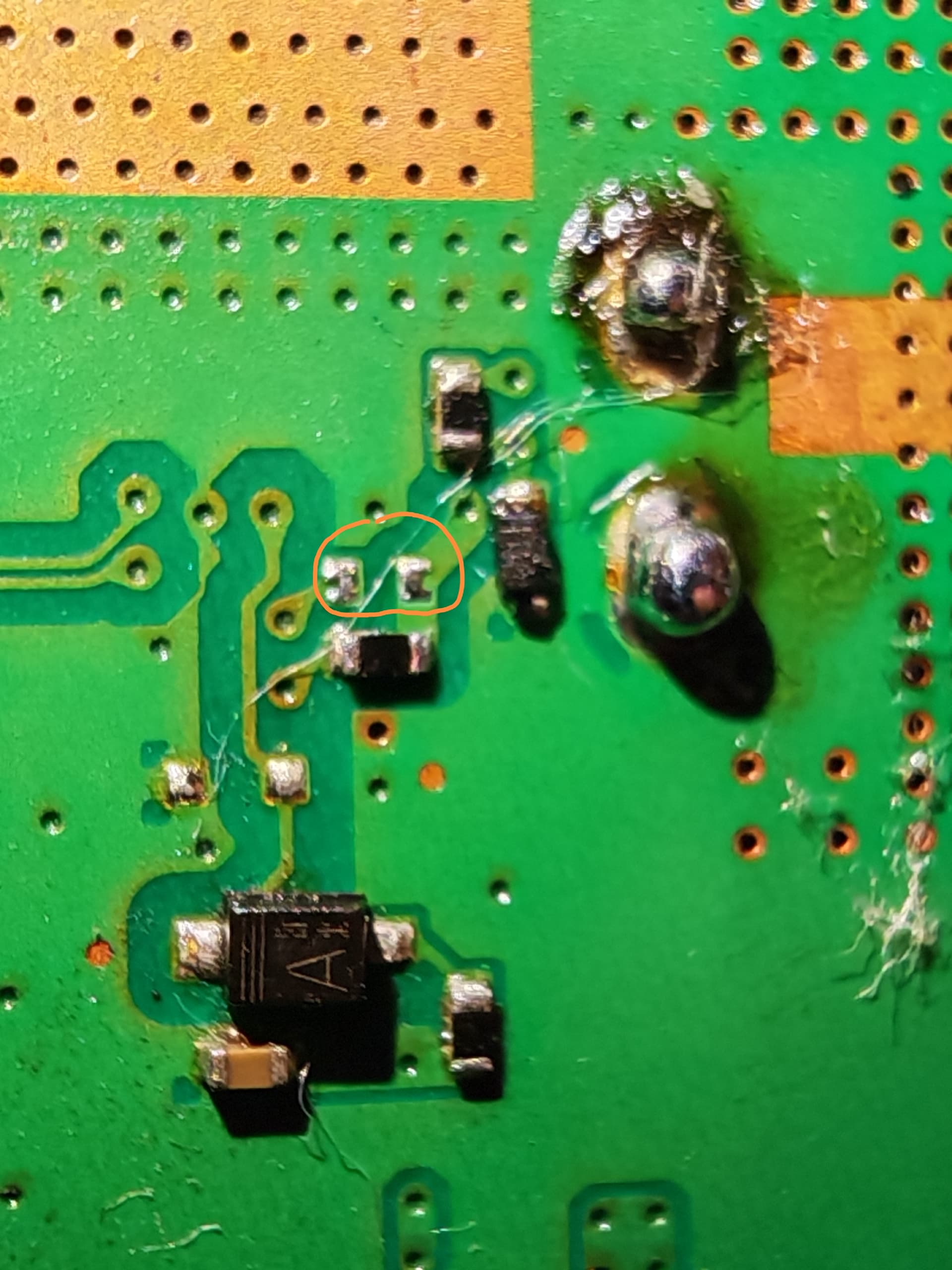

Hi guys,
I accidentally knocked off a component while replacing the HDMI port on my PS4 (sac-001 motherboard).
As i cannot post pictures, it’s one of the two stacked componet behind the HDMI port (on the other side of the bord) next to the DJ diode (from what I read on other topics).
Could someone help me identify it ?
Thanks!

The missing component (resistor?) is showed here also :
https_://imgur.com/a/nVxZqbr

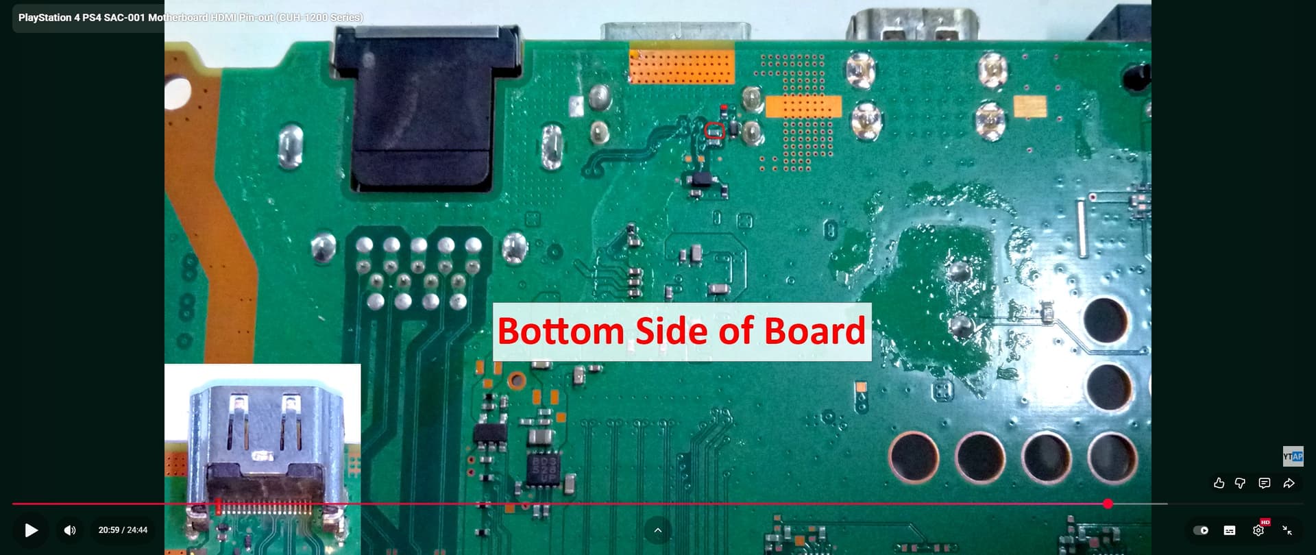

That should be a 2k resistor, according this post

Damn, you’re the best !!! Thank you so much!
