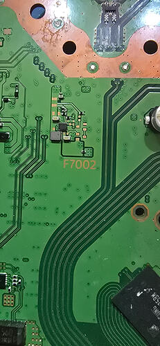

Good day I need help identifying this chip it’s an 028 marking on it. It’s an 8 pin 5v vcc. Your help will be greatly appreciated.

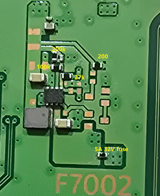

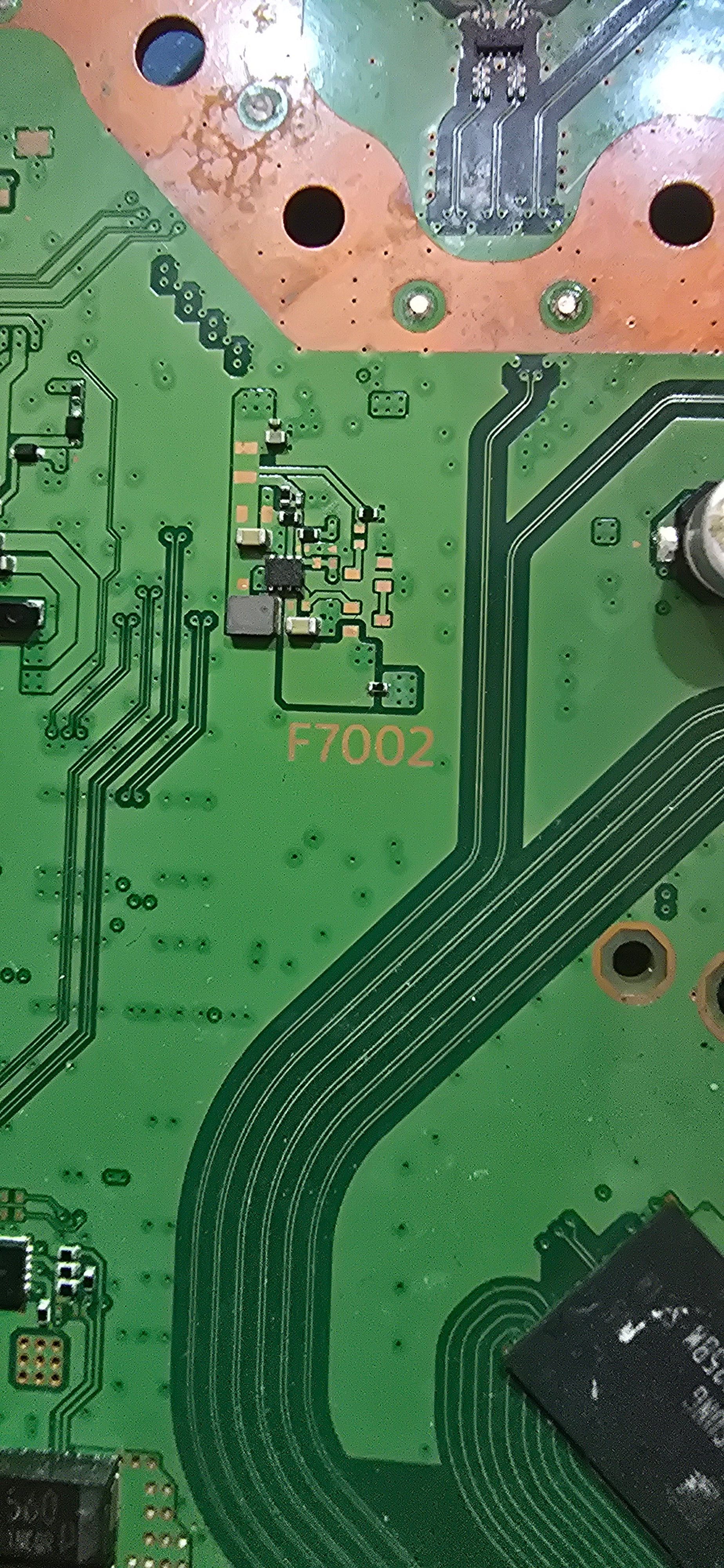

Hi do you know the value of the resistor on the far right took it out to measure it and it went flying.
if you are talking about this area
This is it exactly, thank you.
