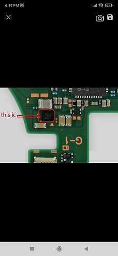

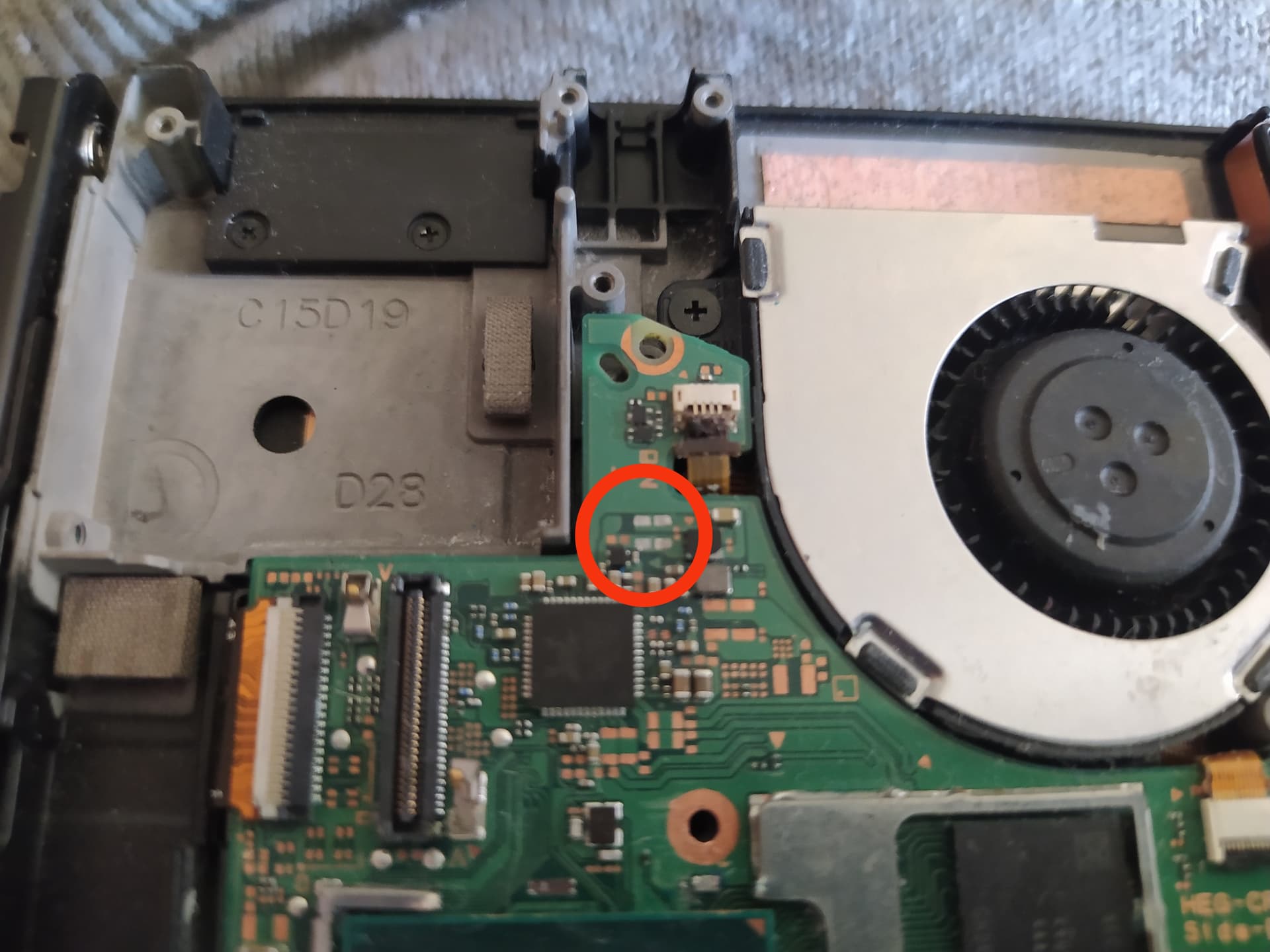

Hello, could you help me identify this component of Nintendo switch oled since they were
lost to me
MAX77801 is the IC. missing 2 caps are 22uf caps imo
I will be able to get these capacitors out of a nintendo switch 1.1 do you think they are close to the same ic max
Should have 2 same 22uf caps on “EN**”/rp602z330c Vout.
