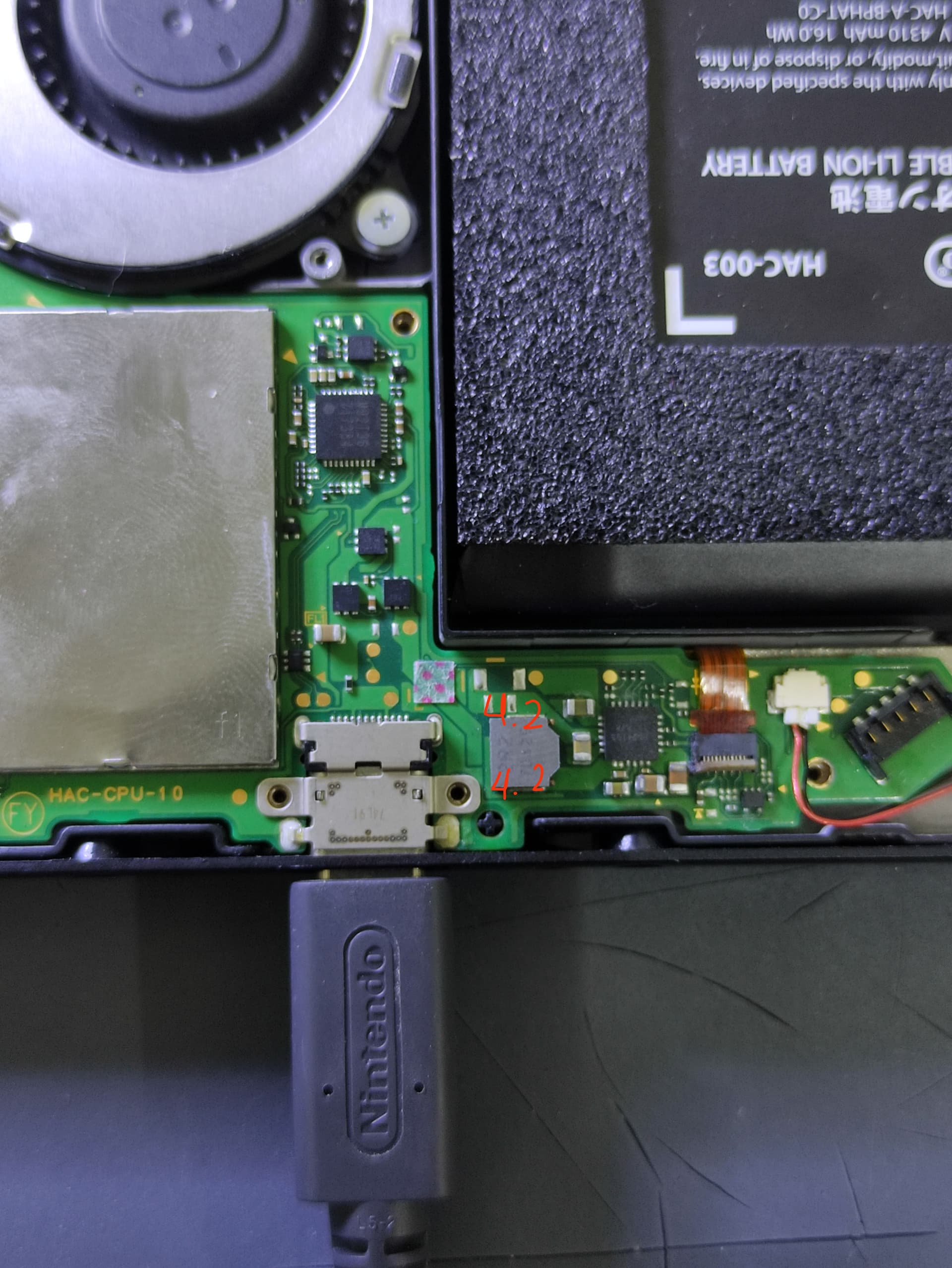

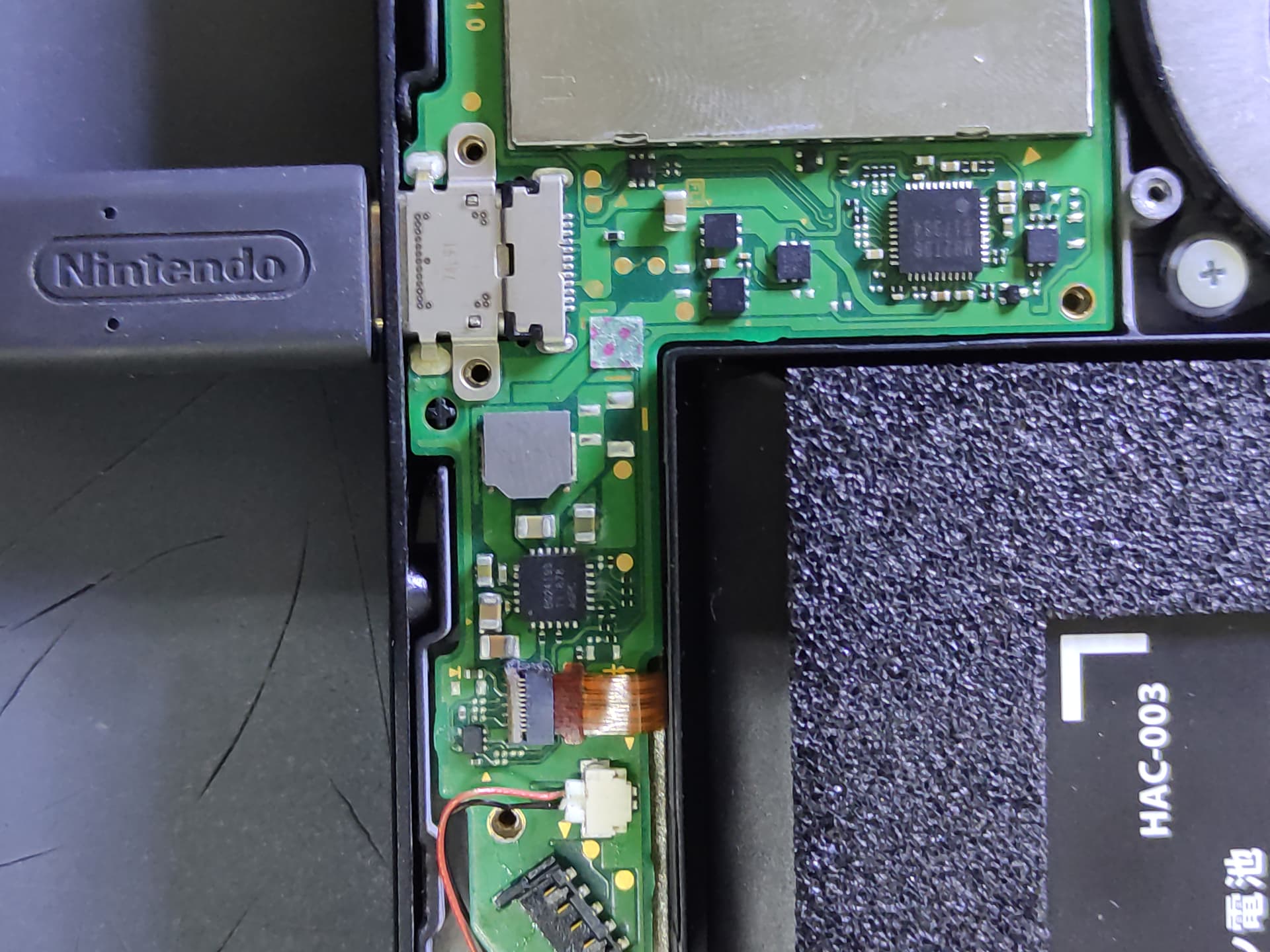

I have a Switch console with a short in a coil near the BQ IC. On both sides I have 4.2v but the console remains without turning on and the cpu together with the ram get hot
that’s the coil that gets hot
