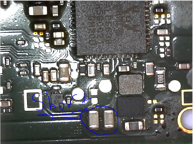

Shorts on some caps. One cap next to m92t36.
One by pi3usb30532. Removed m92t36 short is still there. Any advice as to what should be checked next would be great.

So with pi3usb removed and the shorts are still there.
here is the location of the other shorts.
Well, that’s not good news. The only thing I know of that will cause this type of problem is a shorted out CPU.
Well that’s is above my capability, so it looks like I have a donor switch.
