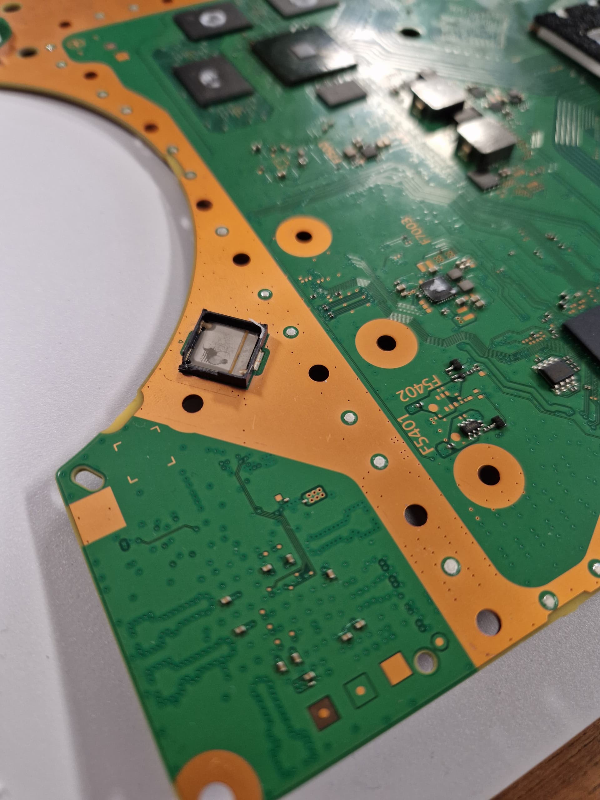

Got a single beep, no light, no power on EDM-010 in today and someone has been into it previously. How do I know? Because they’ve obliterated whatever this component was!

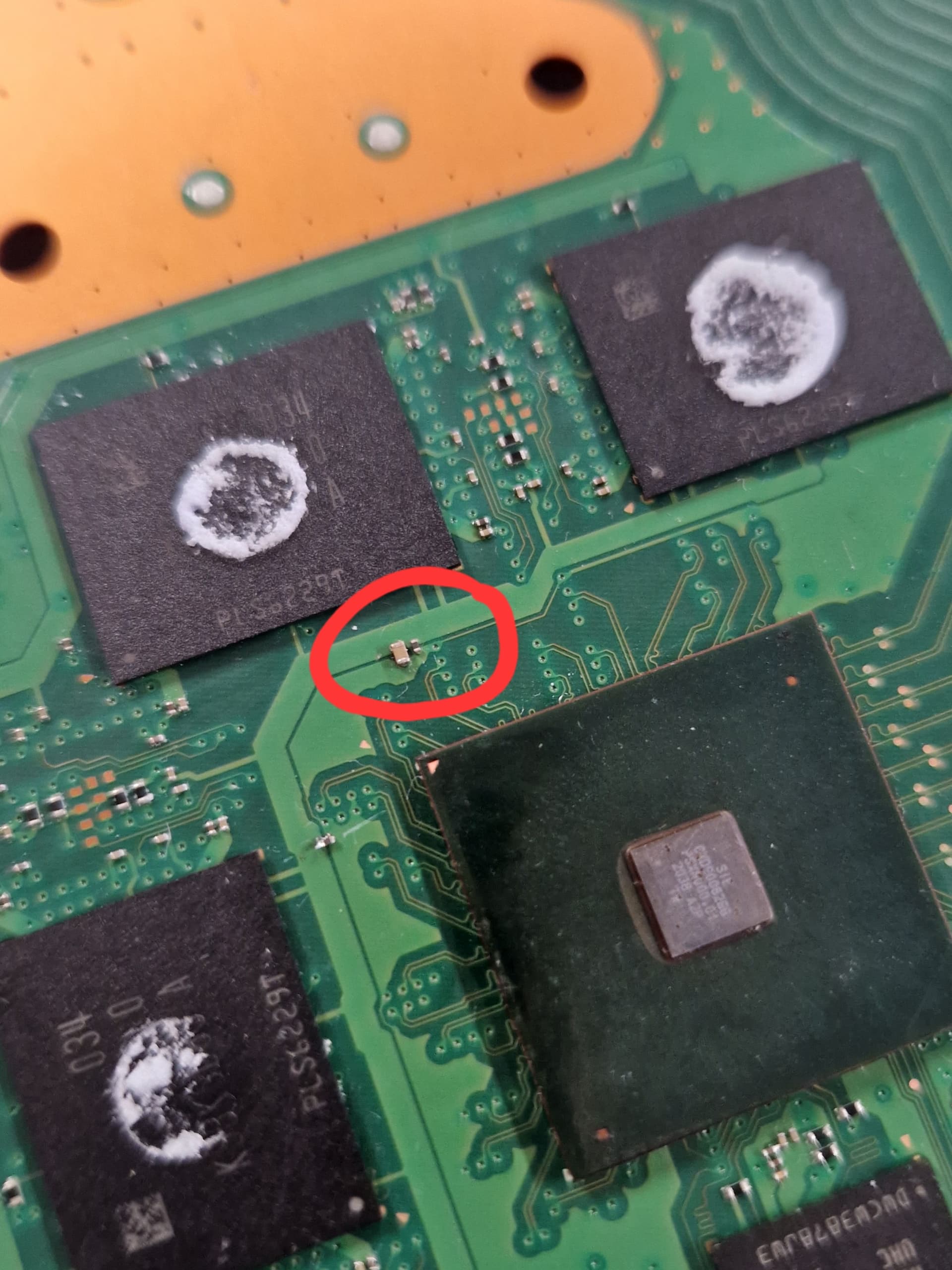

Can’t find an obvious source for the issue, but there’s a couple of caps showing short beside the SSD controller. I think someone might have tried to replace the SSD controller because that part of the board was sticky with flux residue.
Also think F7003 is blown but can’t find a short the other side of it.
Anything else obvious I should check for, or do I just give up? If someone has done a bad job replacing the SSD I don’t know what else they might have broken…
