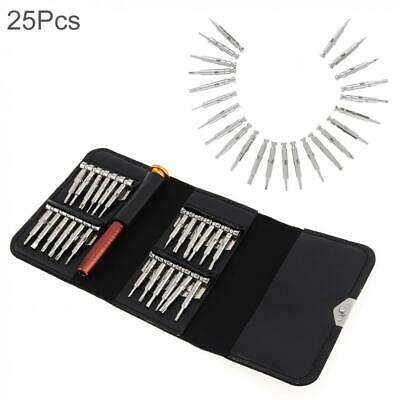

Think the cause of this issue is likely as result of the wrong size tri-wing screwdriver being used, plenty of sellers are selling a tri-wing screwdriver (red handle usually) intended for DS which is not a match for switch and/or theyr’e selling screwdrivers which may as well have come out of a christmas cracker with cheese grade steel which can manage taking out a couple of screws before the end starts sheering off afterwhich it shreds all remaining screw heads
I have the following which has two tri-wing style bits included, one which is a perfect match for the Switch tri-wing screws

Both the tri-wing bits in the leather case set in mine are marked with the size 2.0 and it seems to be a perfect fit my end, dunno how your amazon ones at Y0 and Y00 compares to that but maybe they’re smaller
I’ve looked over the place and a lot of others recommended these screwdrivers, I doubt they are the problem
