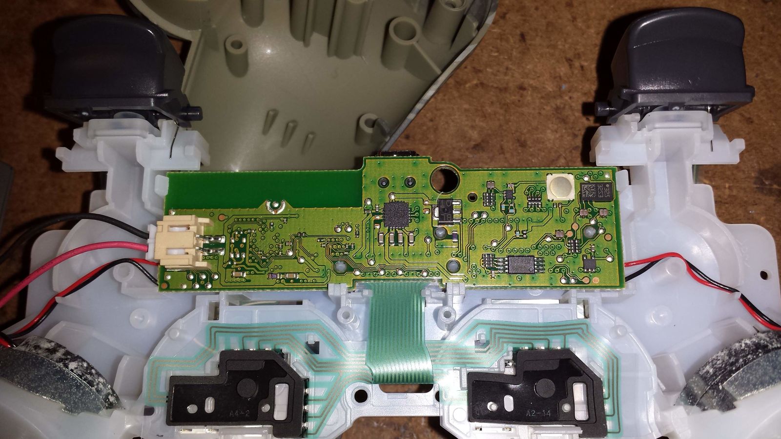

I have a PS3 slim and Dualshock 3 that came with it. The joysticks get stuck all the times and are unresponsive. So I would like to replace them, but the problem is how to properly remove them and find compatible replacement joysticks. For reference, in my Dualshock 3 the joysticks are not soldered on but connected via ribbon cable. As original Dualshock 3 are not available around anymore, this fix is only way to get back to those old memories.

Unfortunately eBay is closed in India. I am attaching picture of Dualshock 3 which I am referring.(source:psdevwiki.com)MSU_VX8_unknown_(Bottom)|690x388

This is an original PS3 Dualshock controller. I’ve worked on several of these. There are 2 of these controllers with small motherboards, 1 with small ic chips and one with bigger ic chips.
@Imtiyaz you can remove the analog stick with a small screwdriver, lift the ribbon away from the leg of the stick and you should see 4 small slots under the ribbon, use the small screwdriver and gently unsnap the stick from the plastic. If you dont have access to ebay you might try something like AliExpress. Hope this helps you out.
Wait that looks like the internals of the old aftermarket skull ps2 controllers try finding one and tearing it down for the internals I used to steal the joycons from them for other controllers because the sticks crack and break
@rmac4411 I have tried removing analog sticks, but placing new stick seems harder because we have to precisely bend the pins. I did find few replacement sticks on Ali express. I will give that a shot and post the progress here.

This is the latest model of the DS3s it’s Original . Most came bundled with the SuperSlims.
you don’t need to bend any pins on the Analog assembly replacement. just make sure that the correct side of the conductive flex touches the pins firmly by pressing the rubber stopper harder in.

I’ve never had to bend pins to replace sticks

my case is 100% the same as @Imtiyaz , unfortunatly, we never seen the progress. my question are the sames as the end of the tread, i opened the ds3, try to understand what @rmac4411 explained but don’t want to break everything…it’s hard to identify the slots under the ribbon to unsnap the stick…it seems that their is 3 pins bended on the plastic that lock it (i can only identifie that…). I think we have to untwist them to unlock the stick but I’m really not sure…and like imtiyaz told, it should be forced to bend them back to lock the new one…but Royginald_PXP & PinkLightning said it’s not needed…i’m completely lost :frowning:

High, I have this same controller and had so search for a while before I ran into someone who made a youtube video fixing this same PS3 controller. In case anyone needs help on this type of controller in the future. Title name on youtube is " Fixing Stick Drift on a DualShock 3: Easier than I thought" by TitanRepairs
