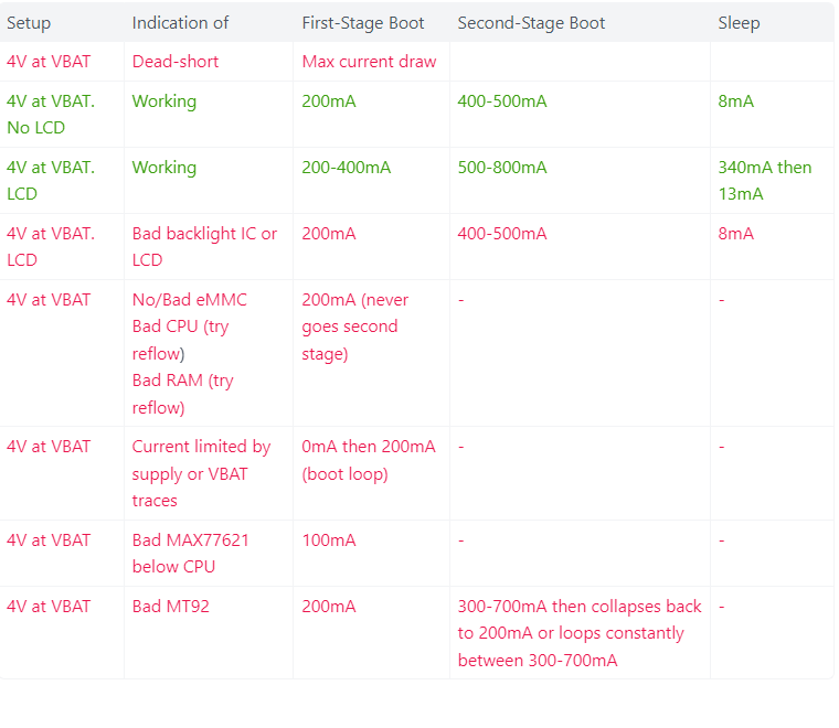

Ok, hooked up my bench PSU and the switch to boot from it (10k resistor between pads on battery connector, + hooked to vbat - grounded to usb shield). Set up PSU to 4.2v with a 2A limit. Injected hekate, current draw stayed at 0A, then injected atmosphere and saw current rise to .22A and stop.
given this chart I think I can conclude I either have a dead APU or bad RAM. I never see second stage boot in any fashion, I know the eMMC is not corrupt or damaged thanks to hekate, so that just leaves the RAM / CPU as potential culprits.
My diagnosis seem right or is there anything else I should try before writing this one off and sending it back to my friend?
