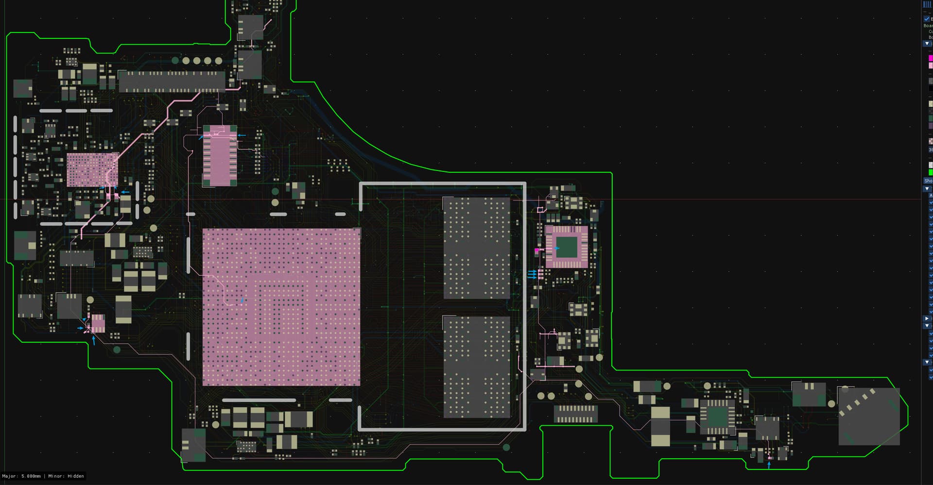

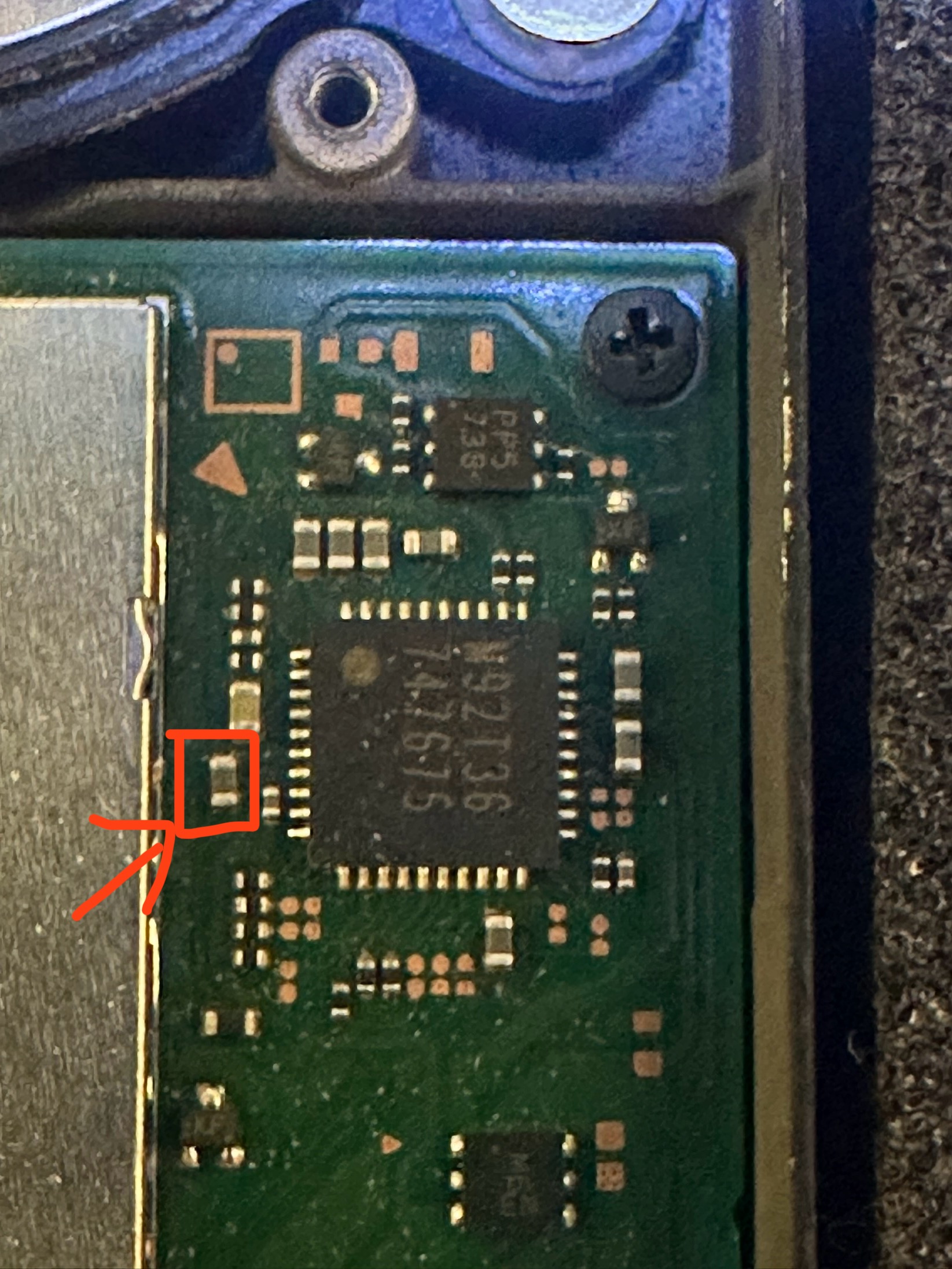

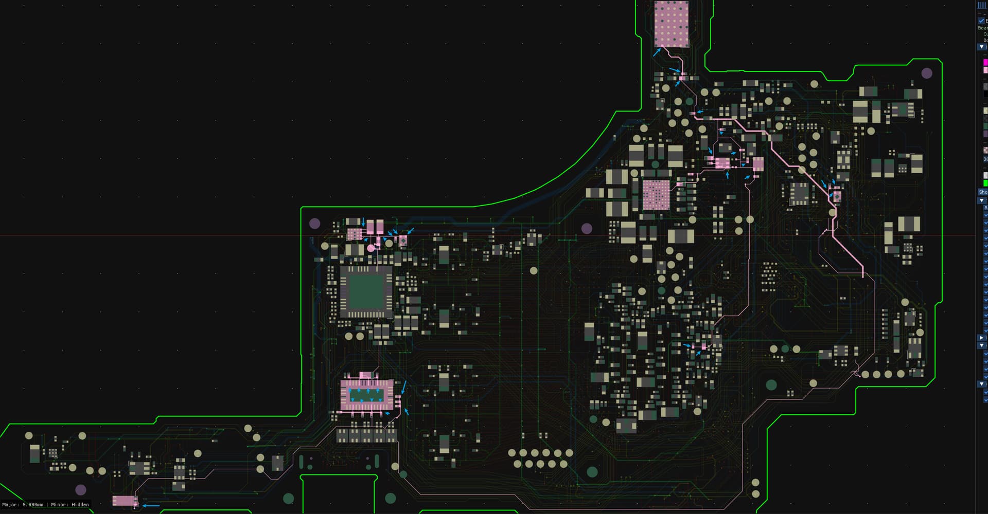

I have a shorted capacitor. And I don’t know which line it is on because I’m a novice.
Do you know where this could be coming from?
Thanks in advance.
Rémi

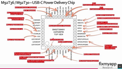

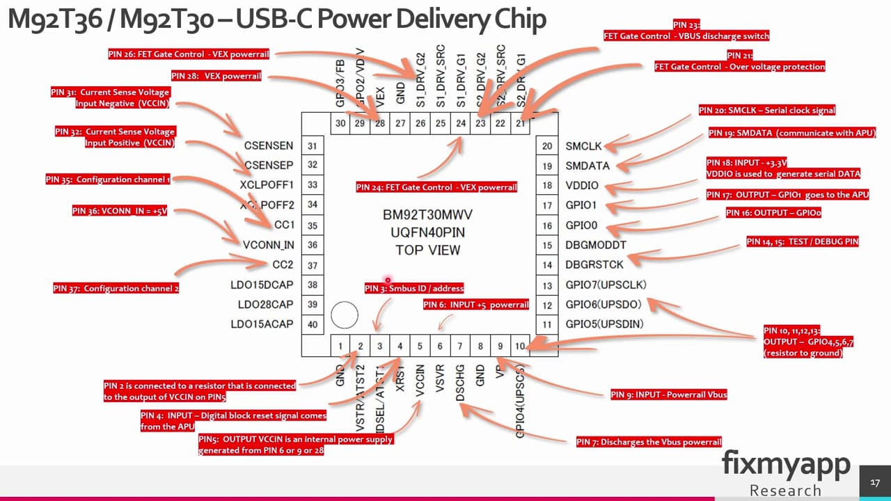

That is off of the VSVR pin, which would be your 5v (3.3v-5v?) power rail (not VBUS). It goes through the pi3usb, max7762, as well as the wifi chip, and emmc slot as well as several other components.
