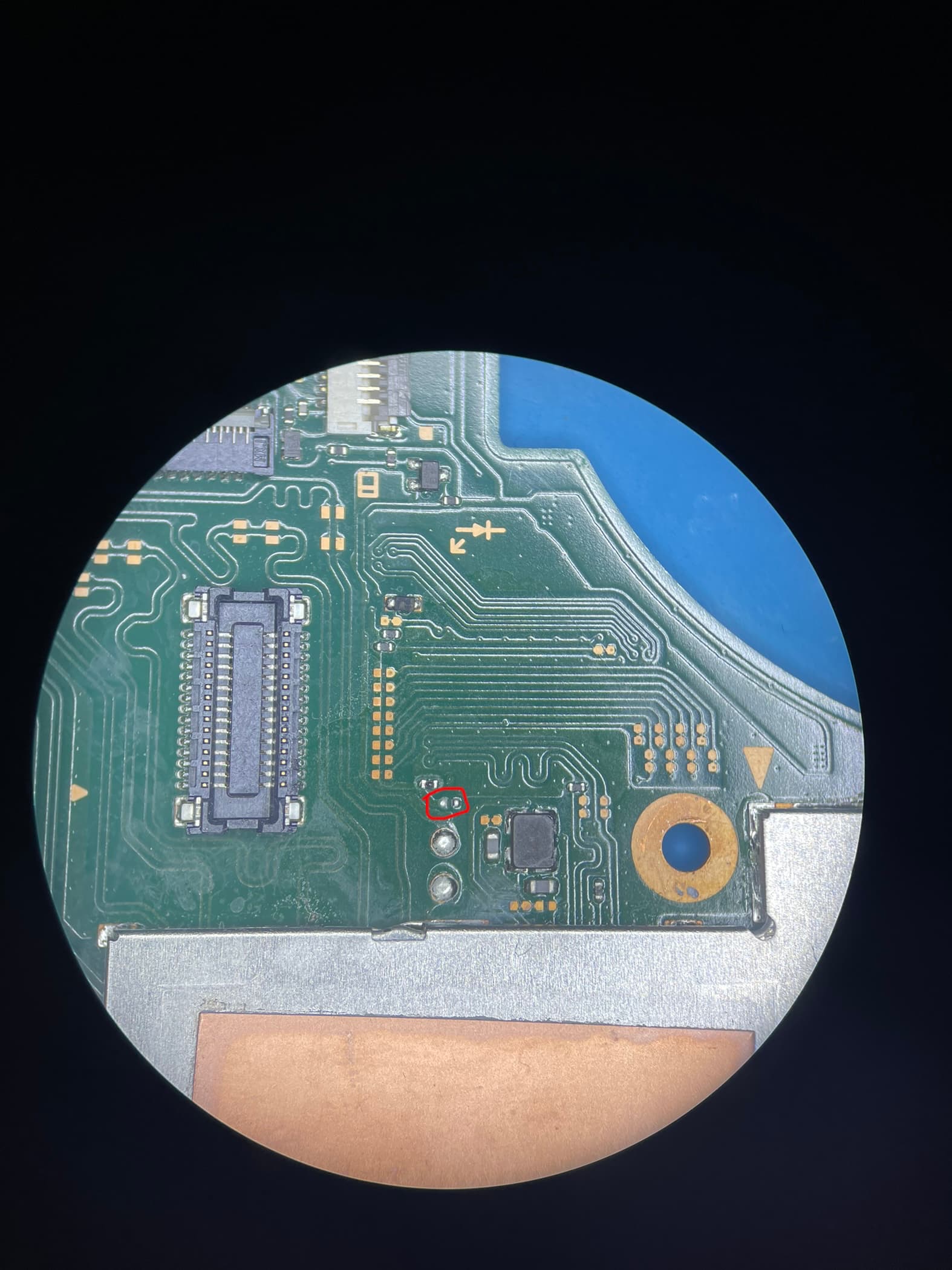

Hello all,
i got a board with a missing component. Its located north of the apu.
Thanks for any help
I dont have any HAD board to check on, and the HAC’s dont have anything there.
Is it ground on one side of it?
Harry
3
Yes it looks like a ground pad on the right side
jkyoho
4
THEY are both 10k resistor there
