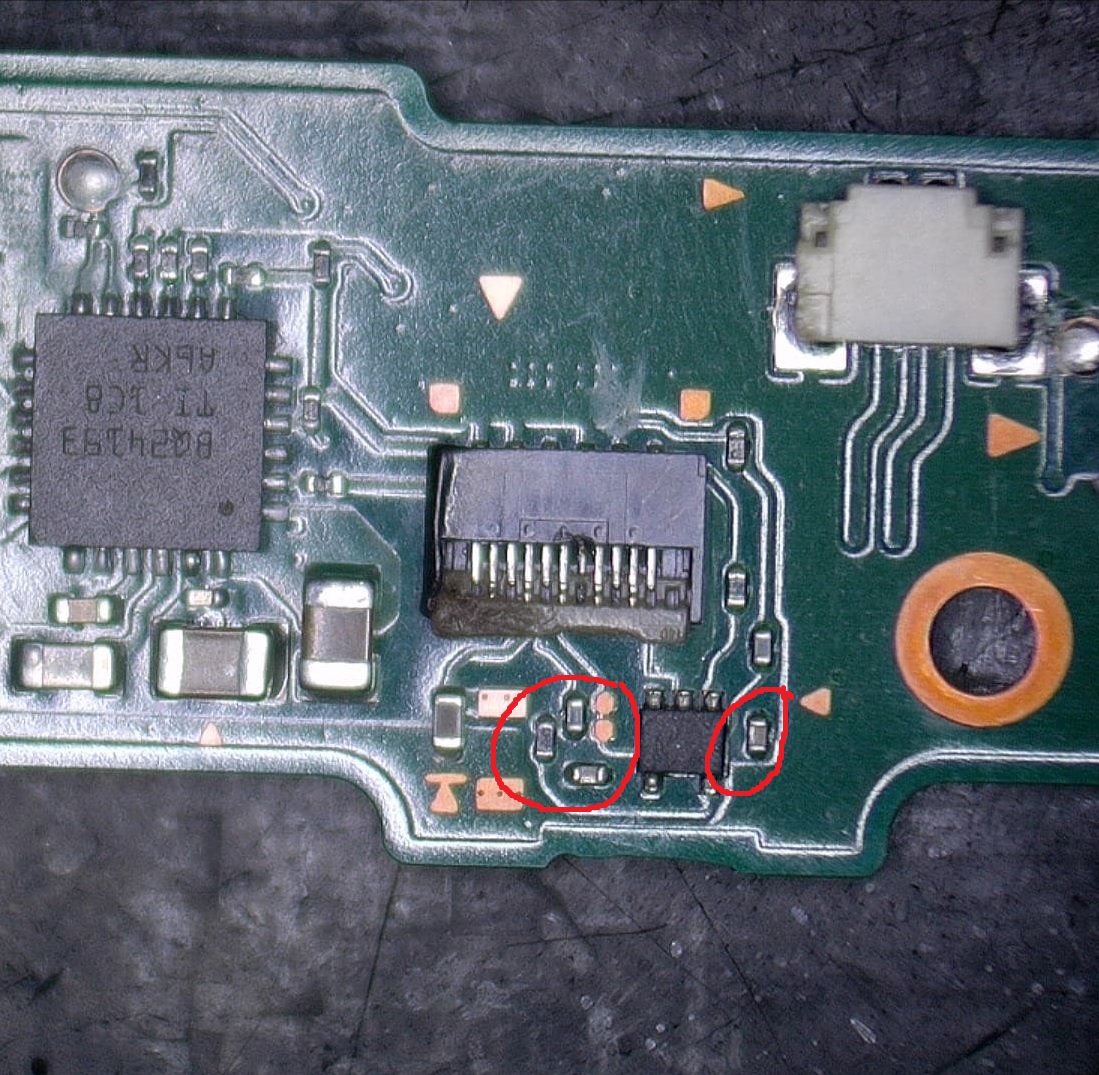

Hi I let some components fly away during some hot air work.
Do someone know what the components are?

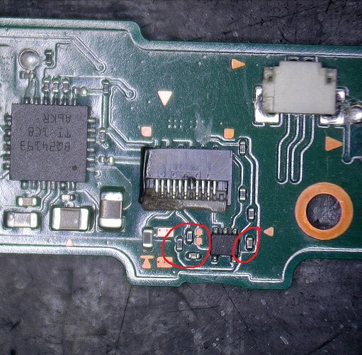

So I m interested in the components near the left Joy Con FPC of a HAD CPU 10 board. Some of them where gone into the 9th dimension and now the Joy con is not been recognised any more.
Okay luckily I found another donor board with those components.
From left:
450 Ohm Resistor
Second had 1 Ohm, maybe an inductor
Third is an Filter cap and fourth also
Maybe this can help someone as weil.
