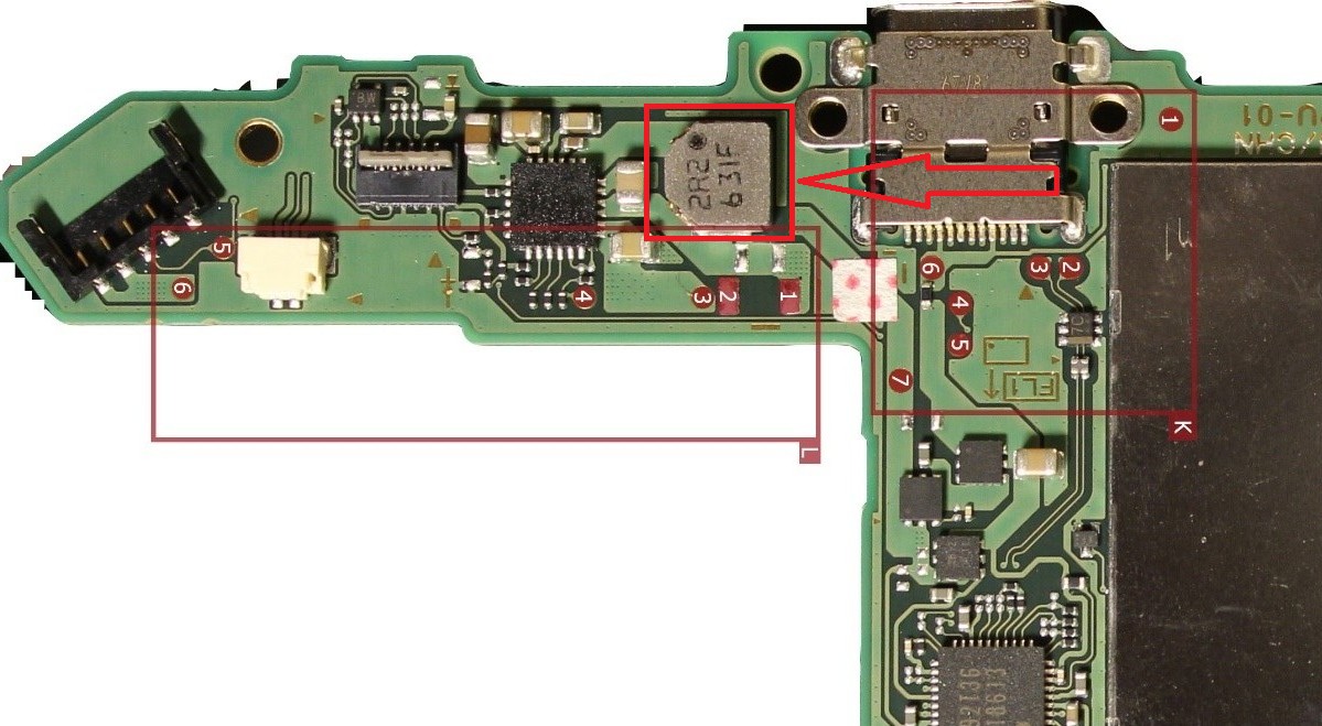

I’ve found a like part replacement for the shielded inductor coil to the left of the USB-C port on the mother board. I’ve found these tend to break off separating from their legs which remain soldered to the board. I’ve used this part as a substitution without issue and it saves from having to scavenge parts from “parts” systems.
www.digikey. com/short/pw0ccb
Sorry for the broken link, it’s a limitation of my user level I guess
These parts can also be repaired depending on how they broke if it’s the wire it’s fixable with just a small bit of solder if it’s the plastic though it’s not so fixable
Hey there,
basically they are repairable, yes. But, in most cases it’s just not feasible. Those inductors cost around a dollar/euro. Considering the cost of your own time and possible repair returns due to those fixed inductors it usually is not worth repairing it. At least that’s my opinion. There are also inductors from other manufacturers that do fit, too. But that one seems to fit fine, too
