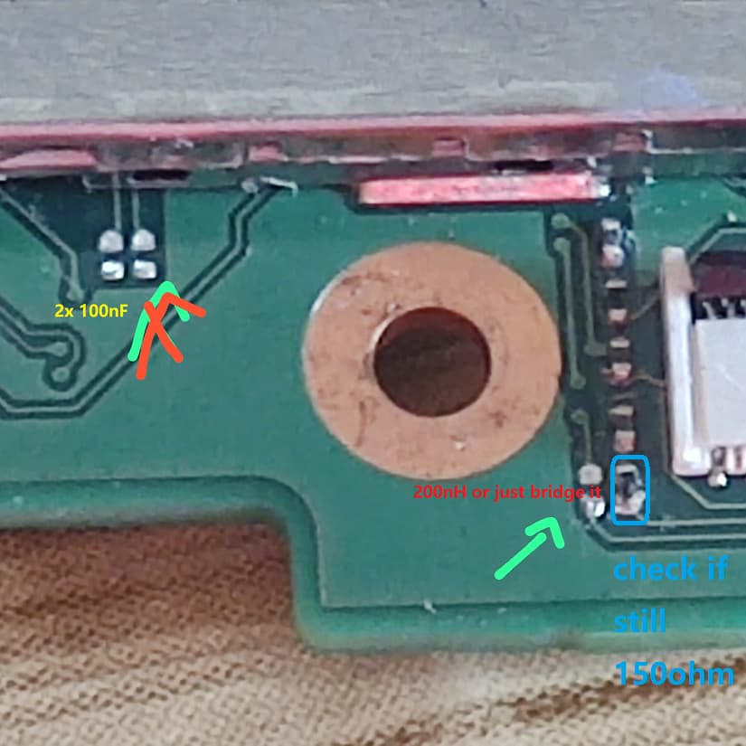

Help with the value of the resistors near the processor!
I have Nintendo switch Oled version hac-001(-01).
I received it with a defect, namely bluescreen. After researching, I performed a reflow on the CPU. Following this reflow, I lost these resistors, I found one.
After I reflowed the console, it started, the touch screen didn’t work, after investigating the problem I was left with no image but with sound.
I can’t find their value anywhere, can someone help me please?
Thank you.

I would like to know what component this is and its value, as when I connected the flex cable, I think I might have pulled it out of place.
you might also need to check the resistor next to the missing FB(JC connector side) still showing 200 ish resistance or not

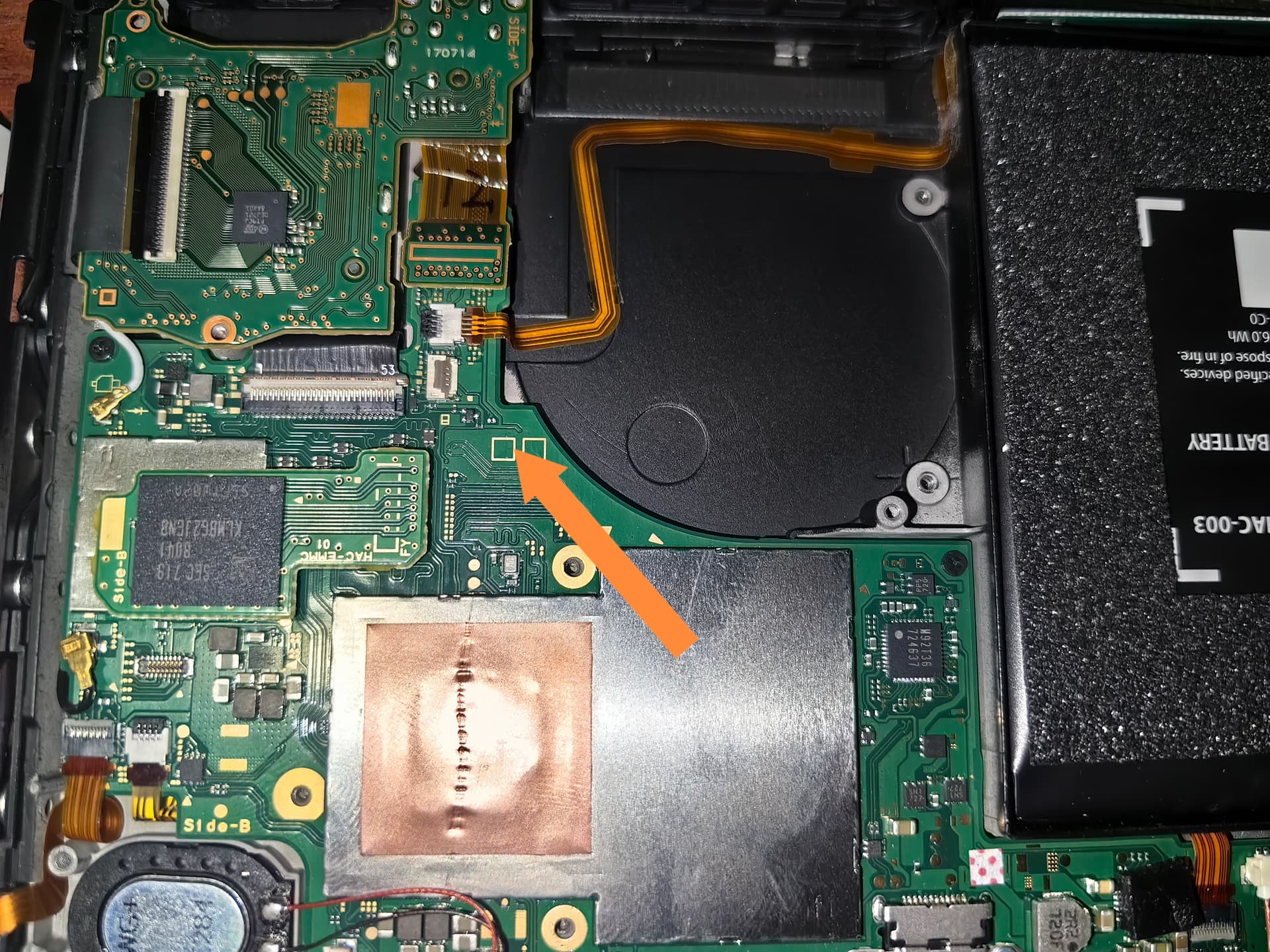

I knocked a resistor off the board. Anyone know what the value of this resistor next to CPU Fan cable socket as attached? Red arrow pointed
