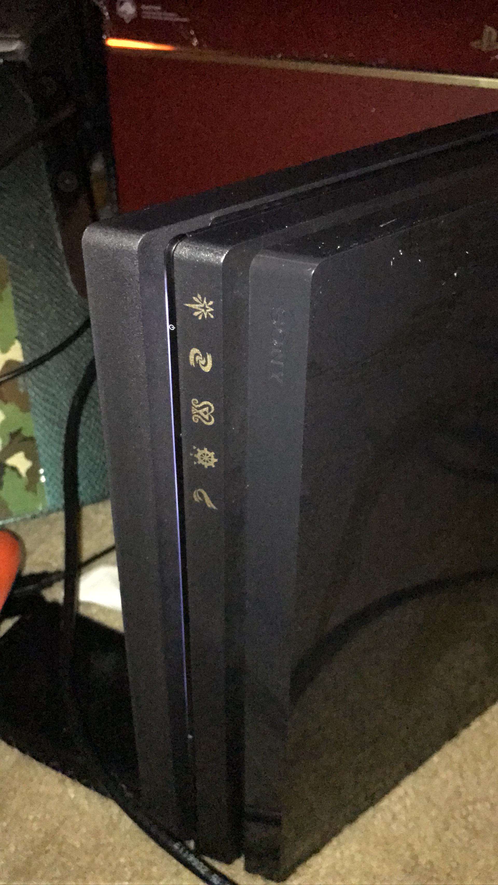

Long story short, my PS4 pro died recently and I decided to fix it after watching one of your videos, I was right on guessing it was the power supply, somehow it got infested with roaches, and it seemed like an easy fix, the problem is, after a couple days after installing the part, my system dies very often, if I leave it on rest mode, I come back to it being completely dead, the only thing that fixed it was unplugging it and waiting several hours, as of right now, that method doesn’t last anymore, it used to last enough to get a few matches in overwatch, but now it dies after trying to do anything with it.
I was reading in the forum and I’ll re open it and take pictures of the motherboard and completely clean off the board maybe there’s roach crap on it, I’ll also re apply thermal paste even though it didn’t look too dry I feel like it will let me see the chip, it might be damaged, is there anything else that could be, I can’t get access to another power supply at the moment, the new one I have I got it from Ebay.

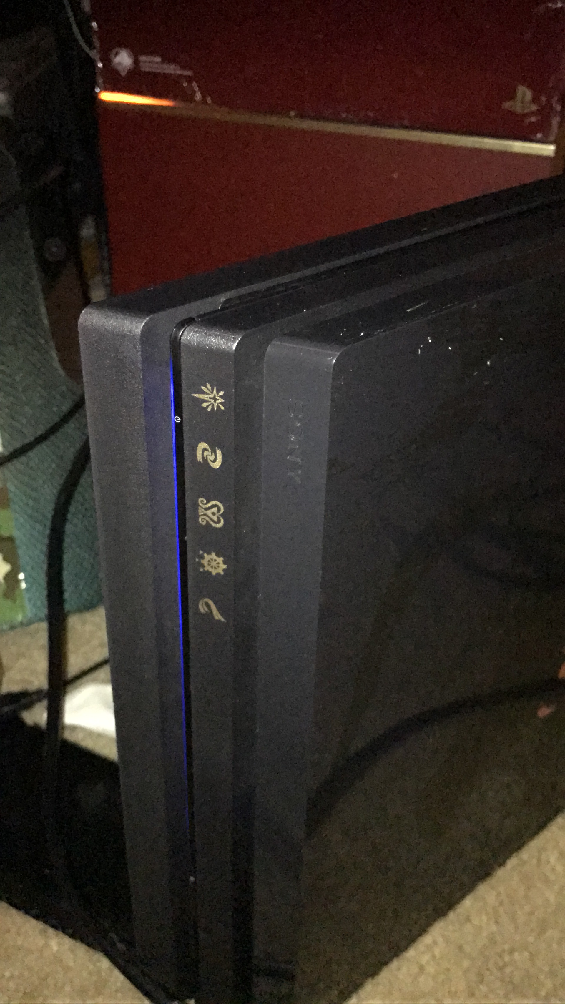

Before I opened it up I decided to plug it again and it works, like I said, it’s not a power supply that’s completely faulty, I just don’t know what is making it power off randomly, no roaches around it seems.
