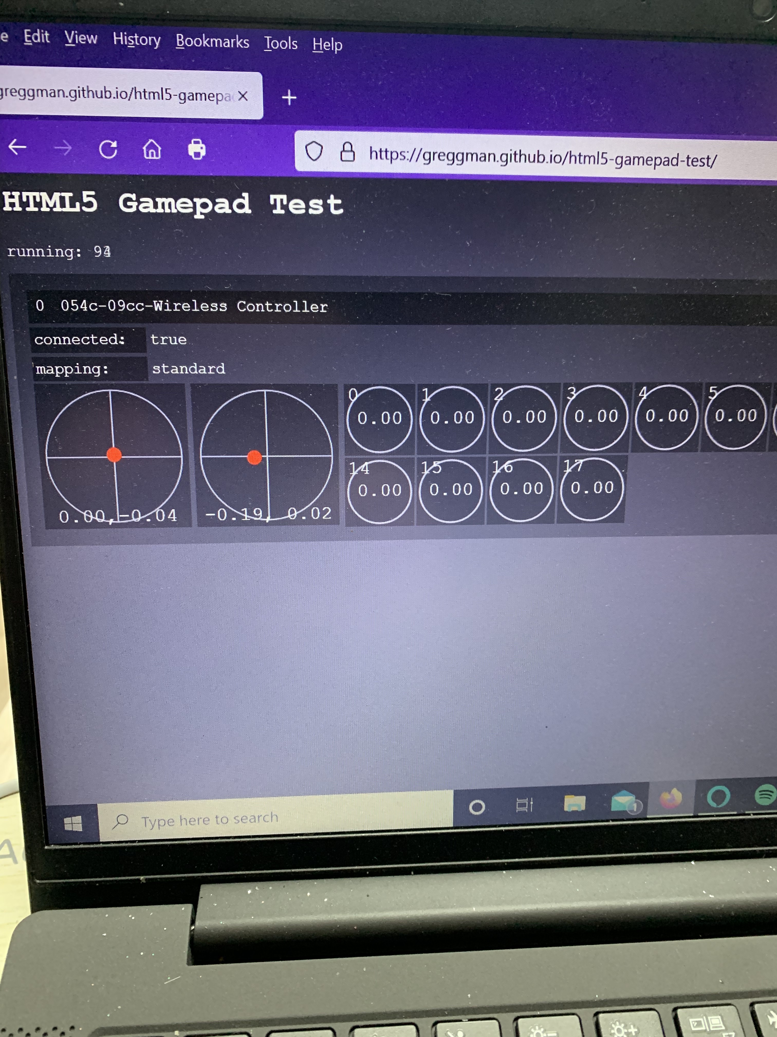

Hello, after some help please from you pros, I have replaced many thumb sticks in many different controllers but I have a couple that the new stick isn’t Center when tested I have replaced the stick again and even just the potentiometer is there any calabration on the PS4 sticks ? The sticks were bought from AliExpress and are Allegedly Alps!
