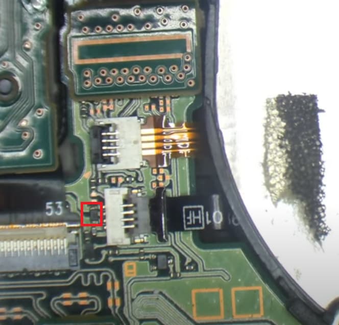

i think there is a little mosfet near the cooling fan that has a chance to go bad. If it does fail it will stop both the fan from working and the joy cons from connecting / charging. Might be worth looking into as a possible fix.
sorry, typo, i said mosfet but pretty sure that’s actually a diode looking at it. Kinda sucks we can’t edit posts past a certain time
