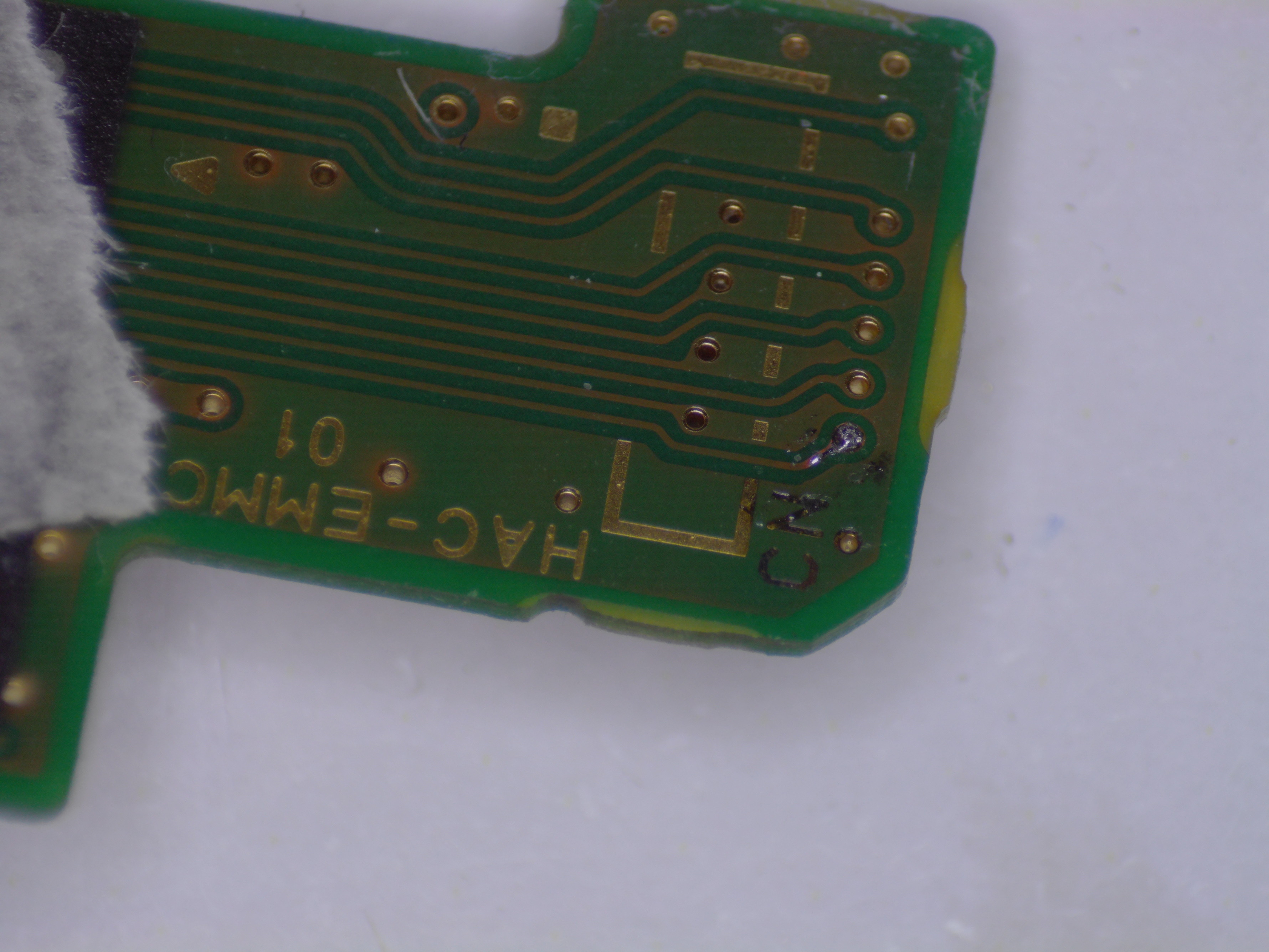

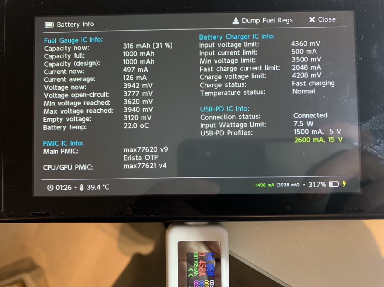

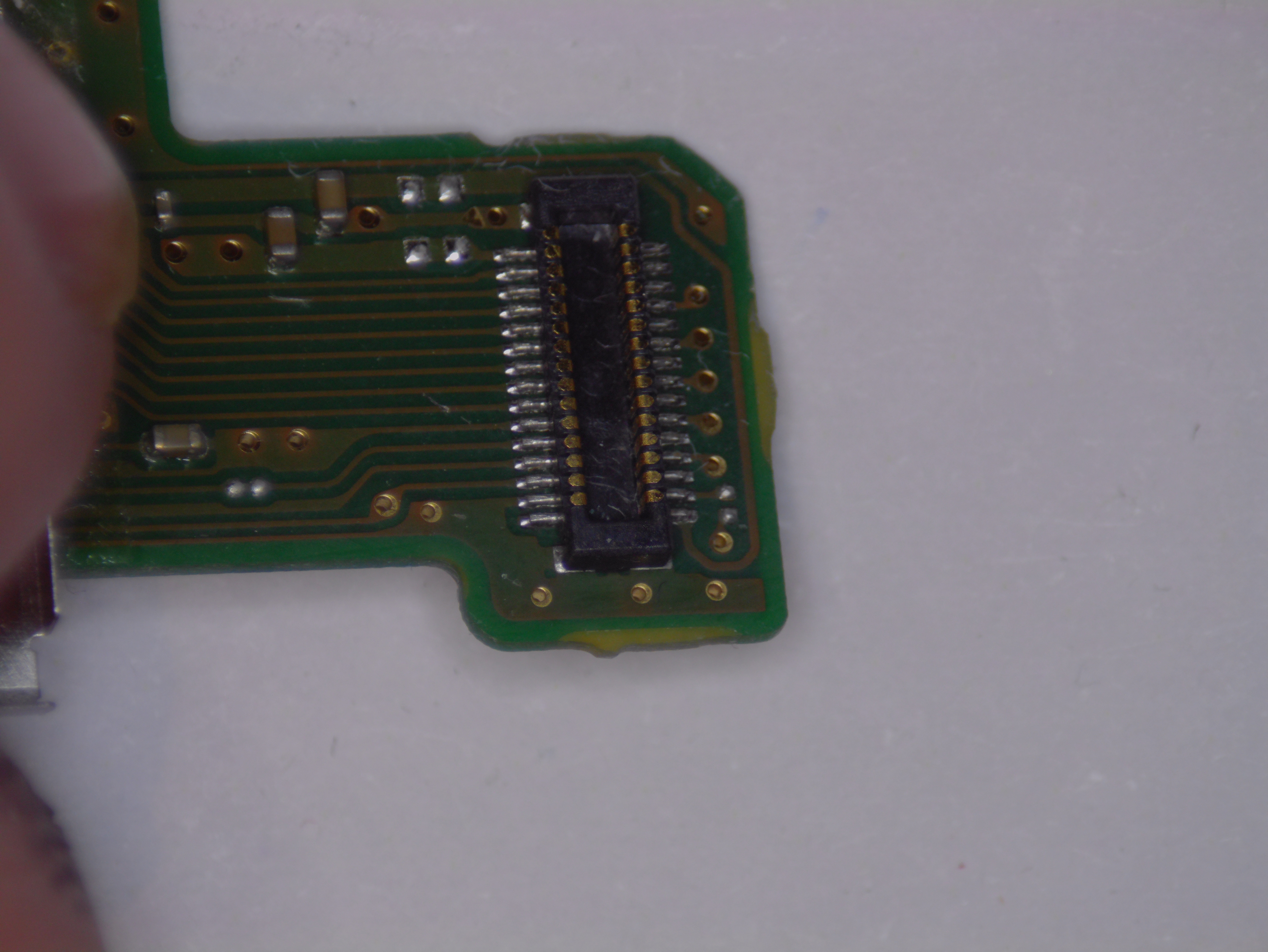

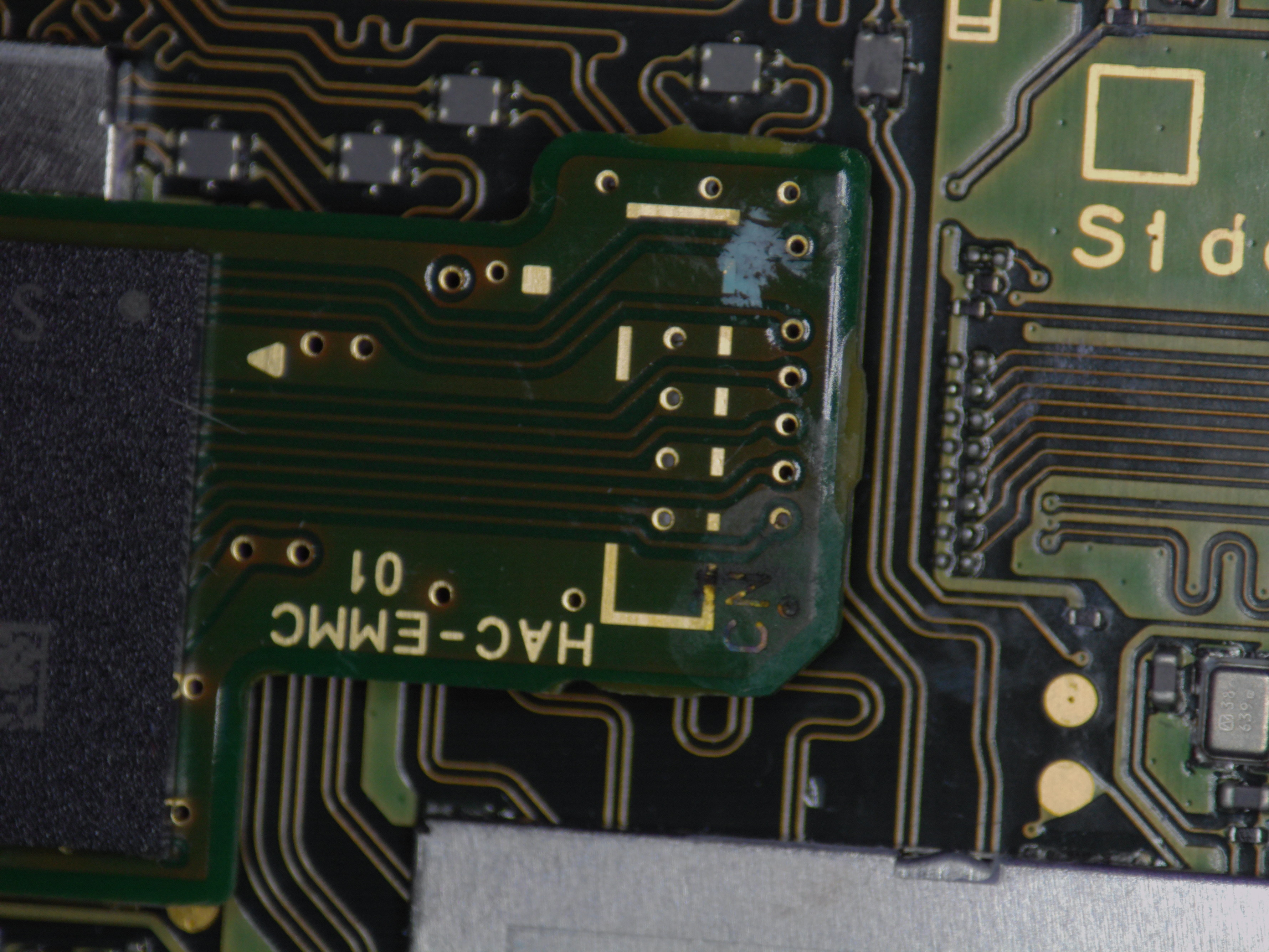

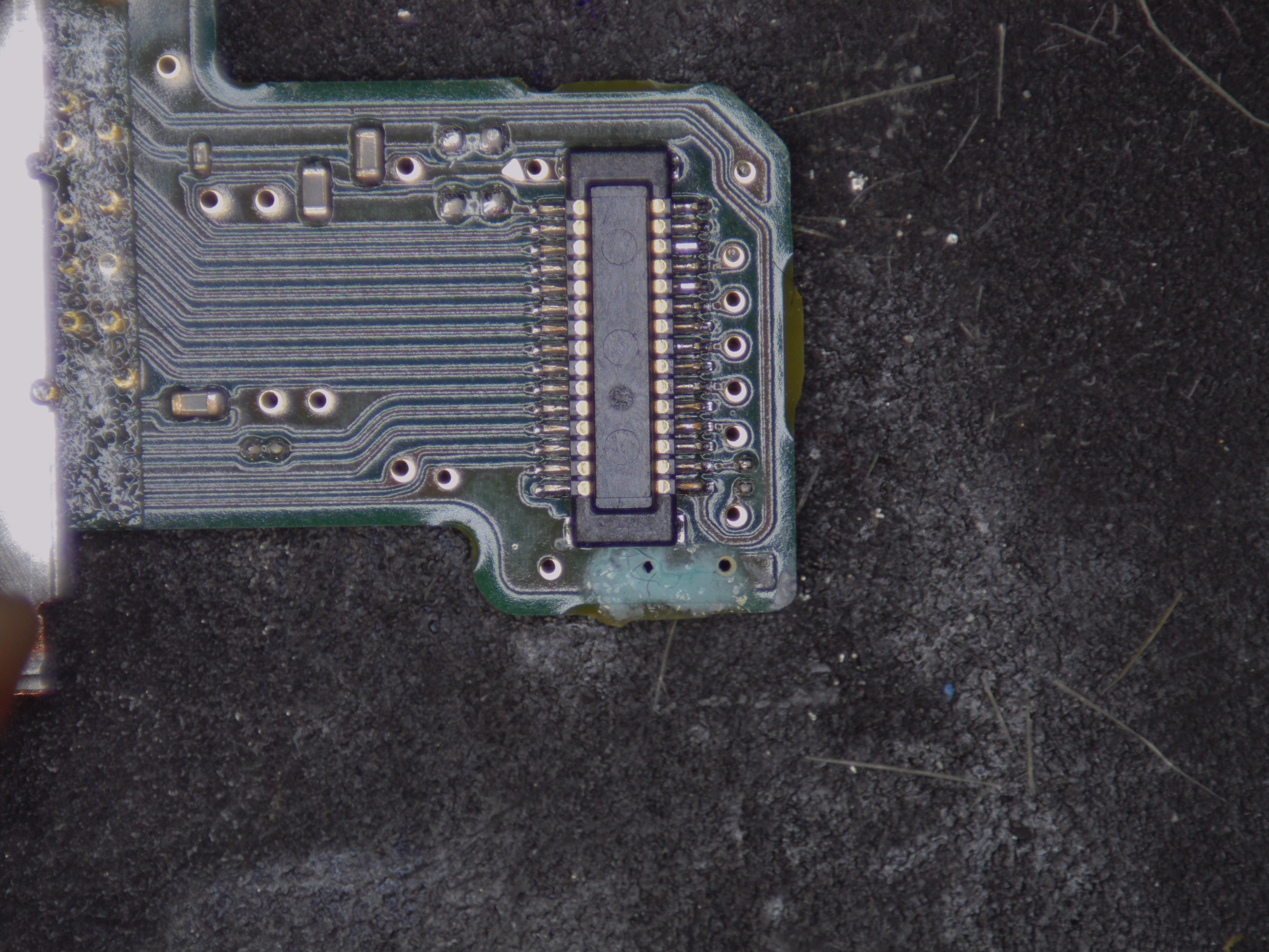

The eMMC initially gave “failed to init” but after some cleaning/soldering work I got the backup. Hekate runs fine and I don’t see any problems in the battery info

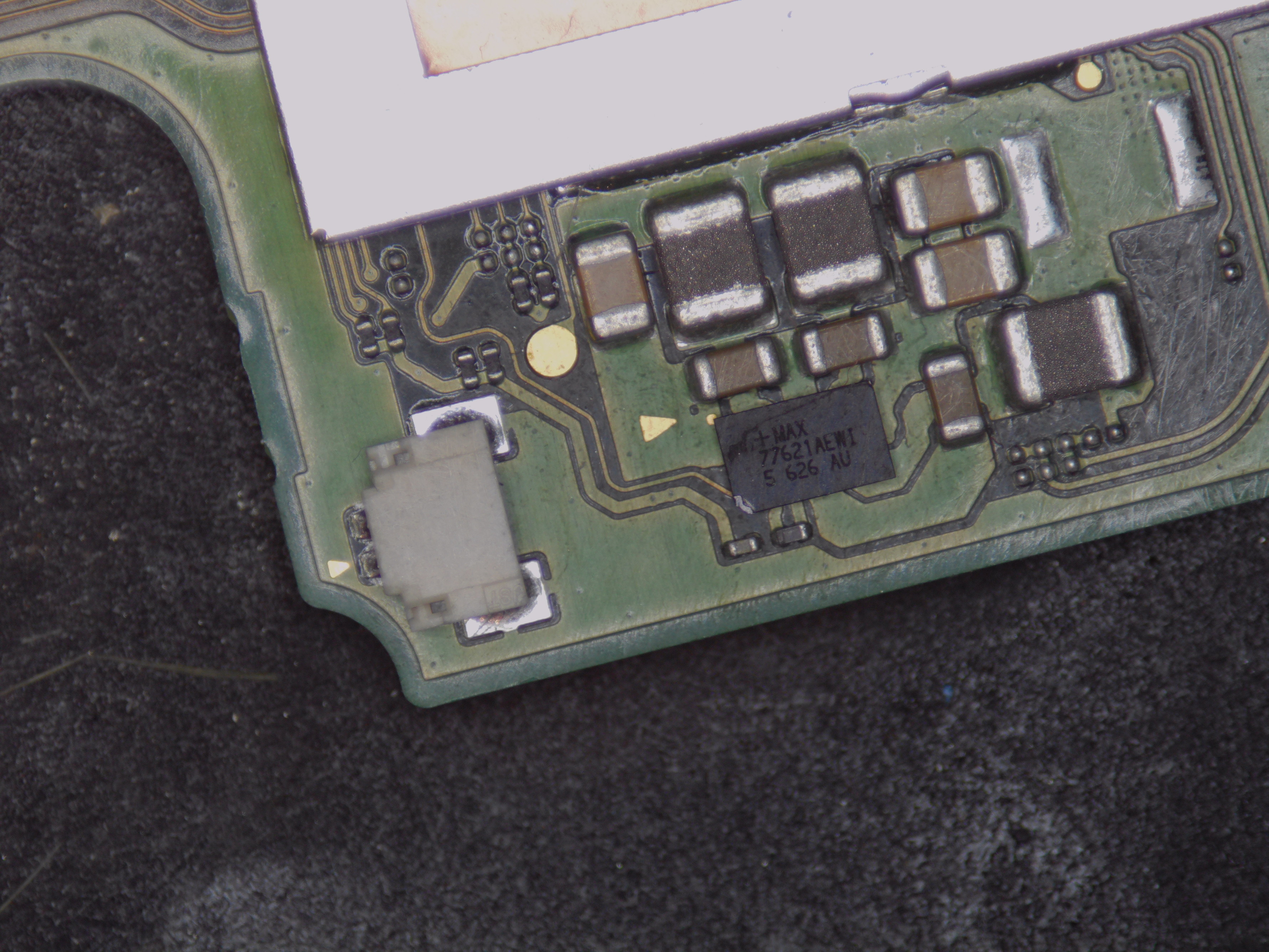

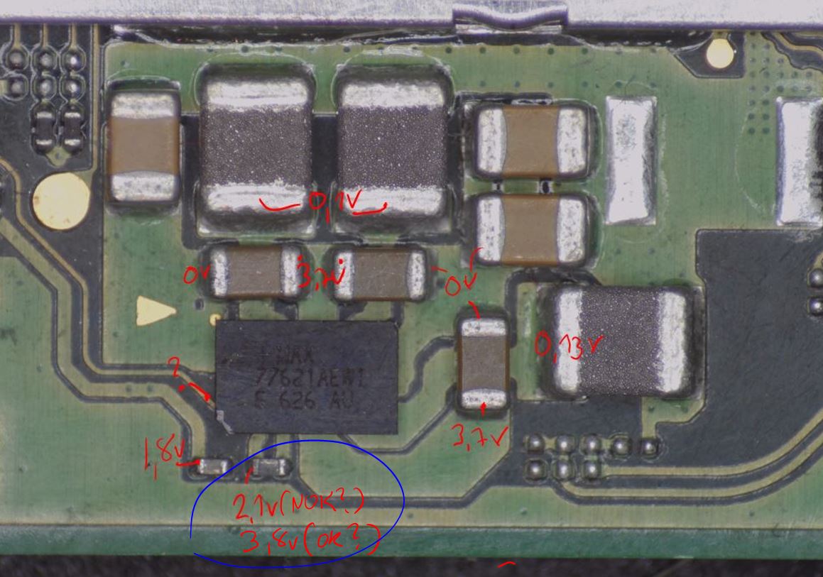

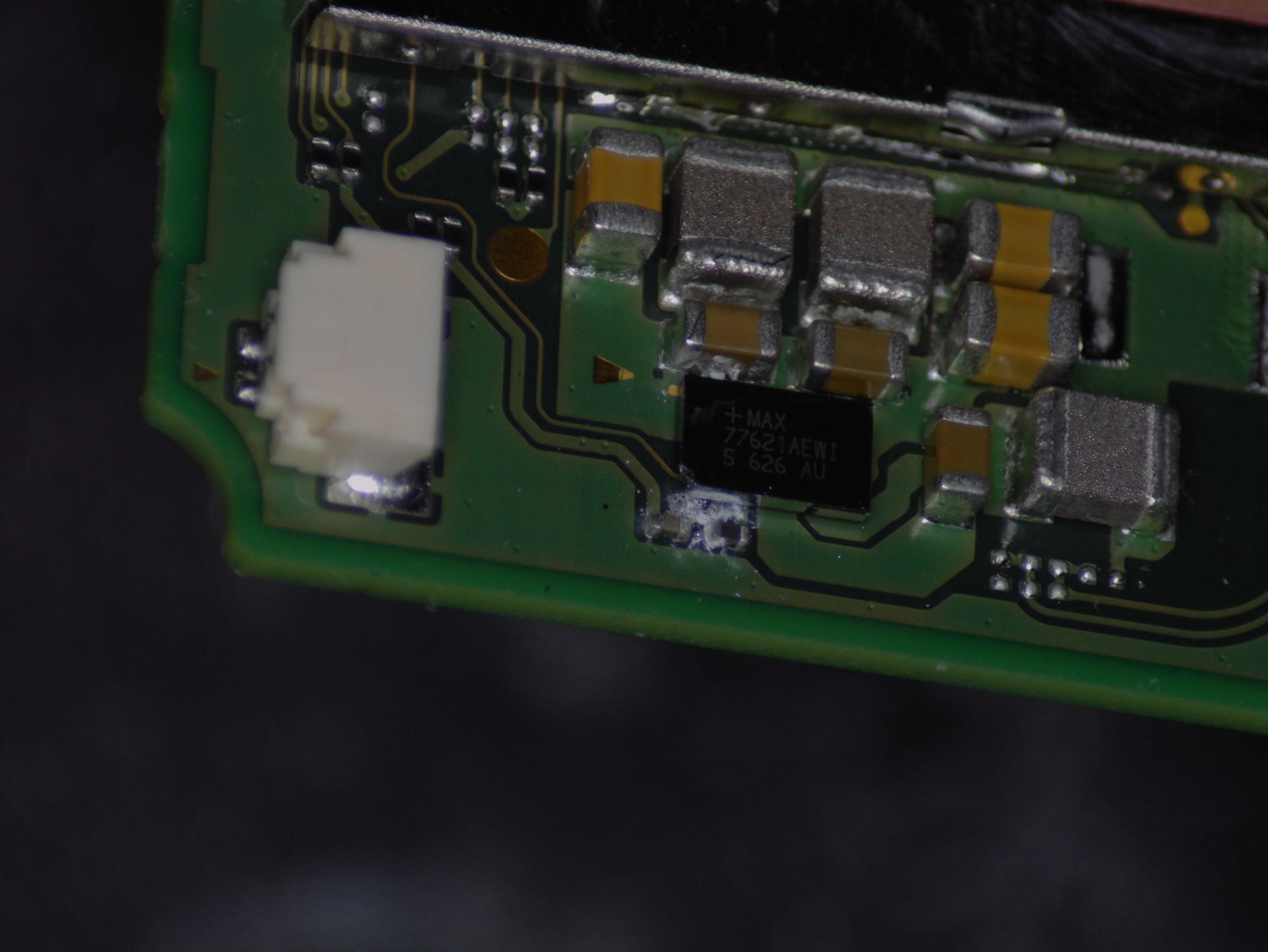

There was a small crack in MAX77621 (CPU buck). I don’t know what has caused this… The switch hadn’t been reworked before. This could be the culprit. I don’t however have this part to replace. One of the lines maybe give strange value (2.1V instead of 3.8V)
What do you guys think?
