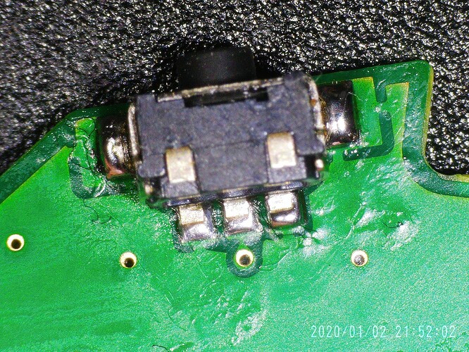

I’ll remove the bad button with heatgun, then clean the board , remove old solder, put new button in place and solder with iron with fine tip and flux (no heatgun there, I don’t want to melt my new button ).

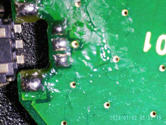

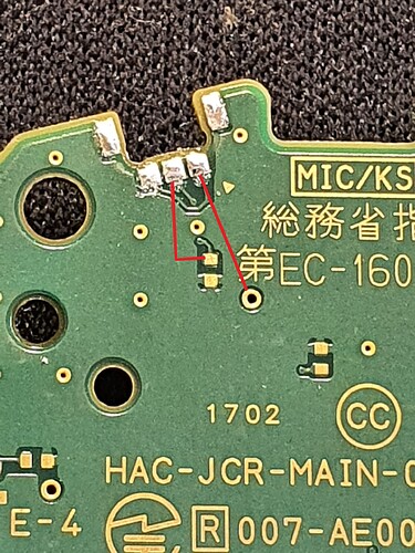

For R-Button replacement for Nintendo Switches usually you need to place 2 wires on the button if the traces are gone (which usually is the case when it’s broken).

I have done several shoulder button replacements on switch lites using original switch buttons. They work fine in my experience.
Would be great if this works - but in my case the buttons are too big to dit in the Lite… not suire if there are different revisions ?
The entire switch doesn’t fit in that recess, just the bottom of the switch. Should be a smaller rectangular plastic pad on the bottom of the switch that fits in that recess.
Well - seems you are fully right - maybe I was a little bit dumb last time and have not seen how to fix it ![]()
Just redone the work and looks ok - cannot test it, but I have a new spare part at least.
Looks perfect. Can’t imagine it not working.
