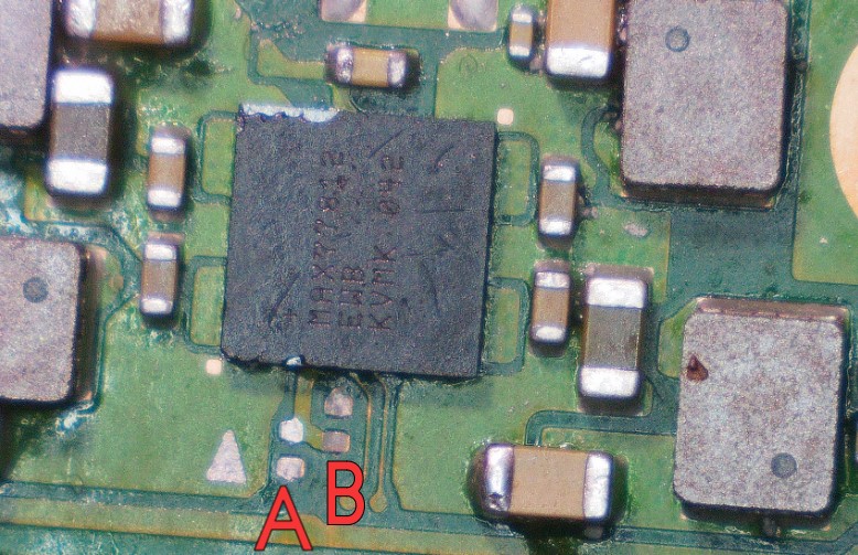

Hi. I blew the 0201 resistor and cap off the board accidentally extracting the MAX77812. I’m a noob. This is a HAD-CPU-10 Mariko board I believe. I think A was a resistor and B a capacitor, but I have no idea what values.
A 100nF cap; B is 10k ohm resistor
Thank You. I wasn’t sure if the values were the same. The layout looked a bit different. I will use those values.
same value, switch lite and v2 switch board share a few circuit design especially when using same MAX77812 ic
Thank You so much. I would have put them on in the wrong spots.
