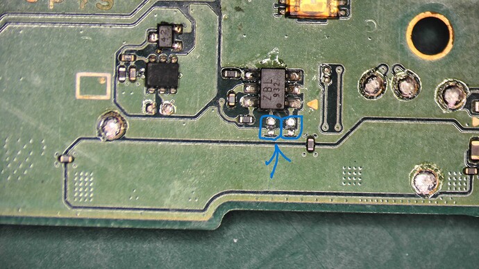

Hi, I was wondering if you could help me find the value of this 2 resistors I lost while soldering BQ24193. The resistors are on the back of BQ24193 next to ZBL932
THANKS IN ADVANCED!

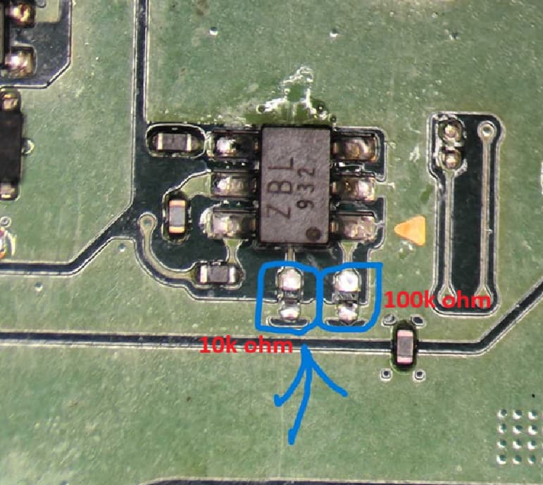

Do you have V1 or V2 mainboard?
I have a V2 main board
The right joycon ZBL resistors value is pretty much identical to left one like this post
Thank You so Much!!!![]()
