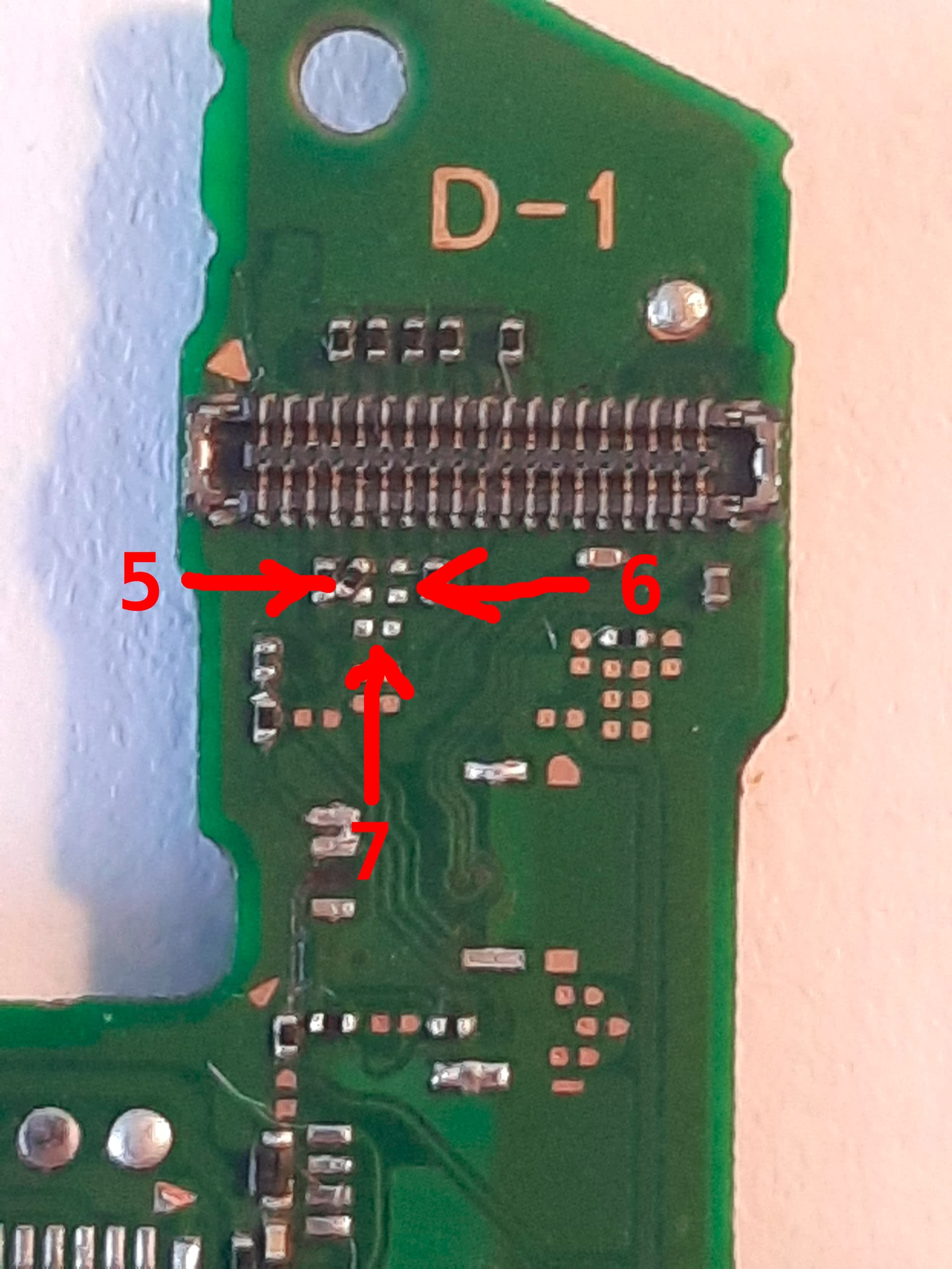

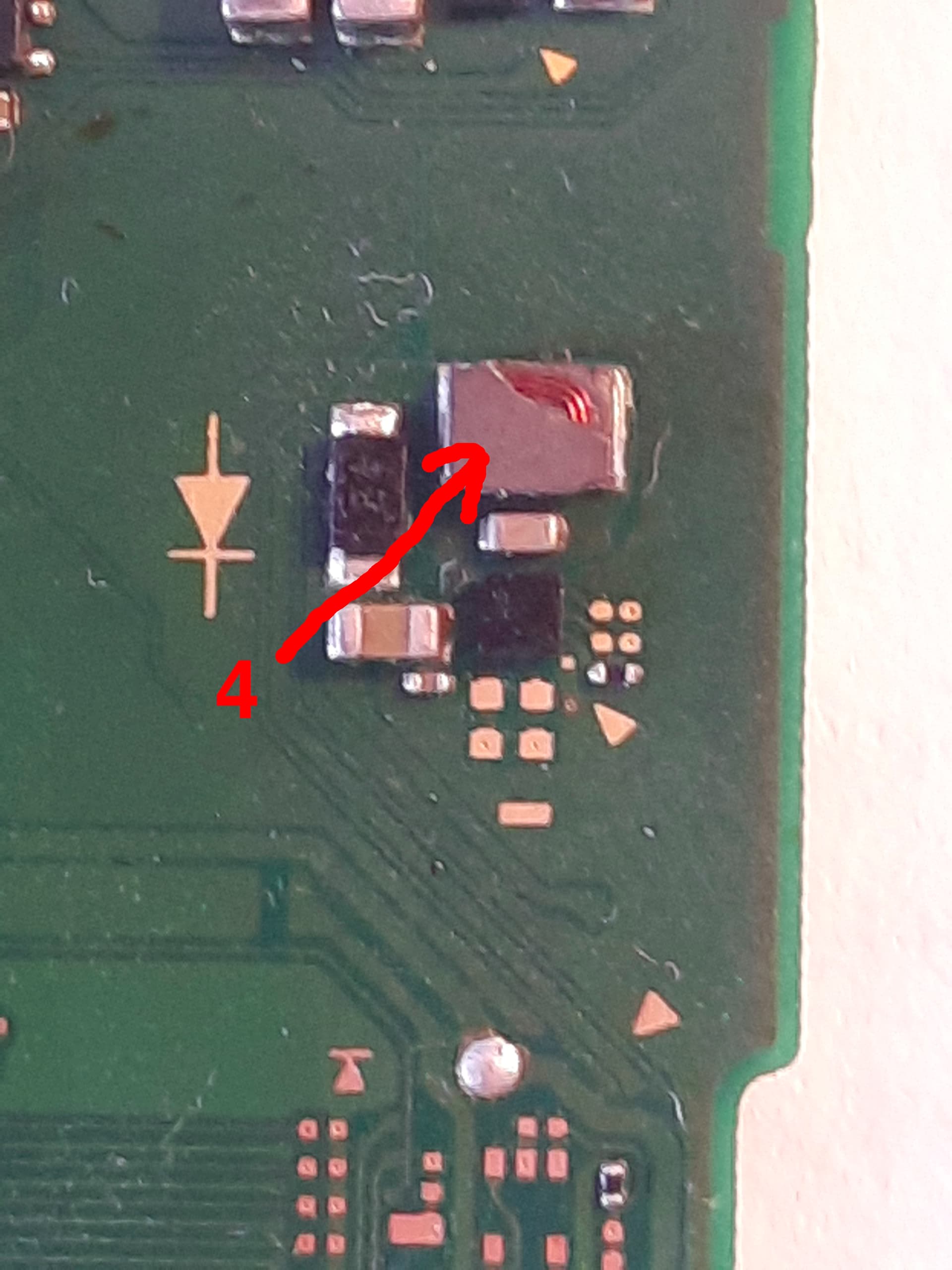

Hi, can you help me to find values of these components for Switch V1?
According to the datasheet for the backlight ic (https://www.ti.com/lit/ds/symlink/tps61163a.pdf?ts=1697369437201) the inductor (4) should have 4.7µH
5;6 = R0201 47 kOhm
7 = C0201 0.12 µF
