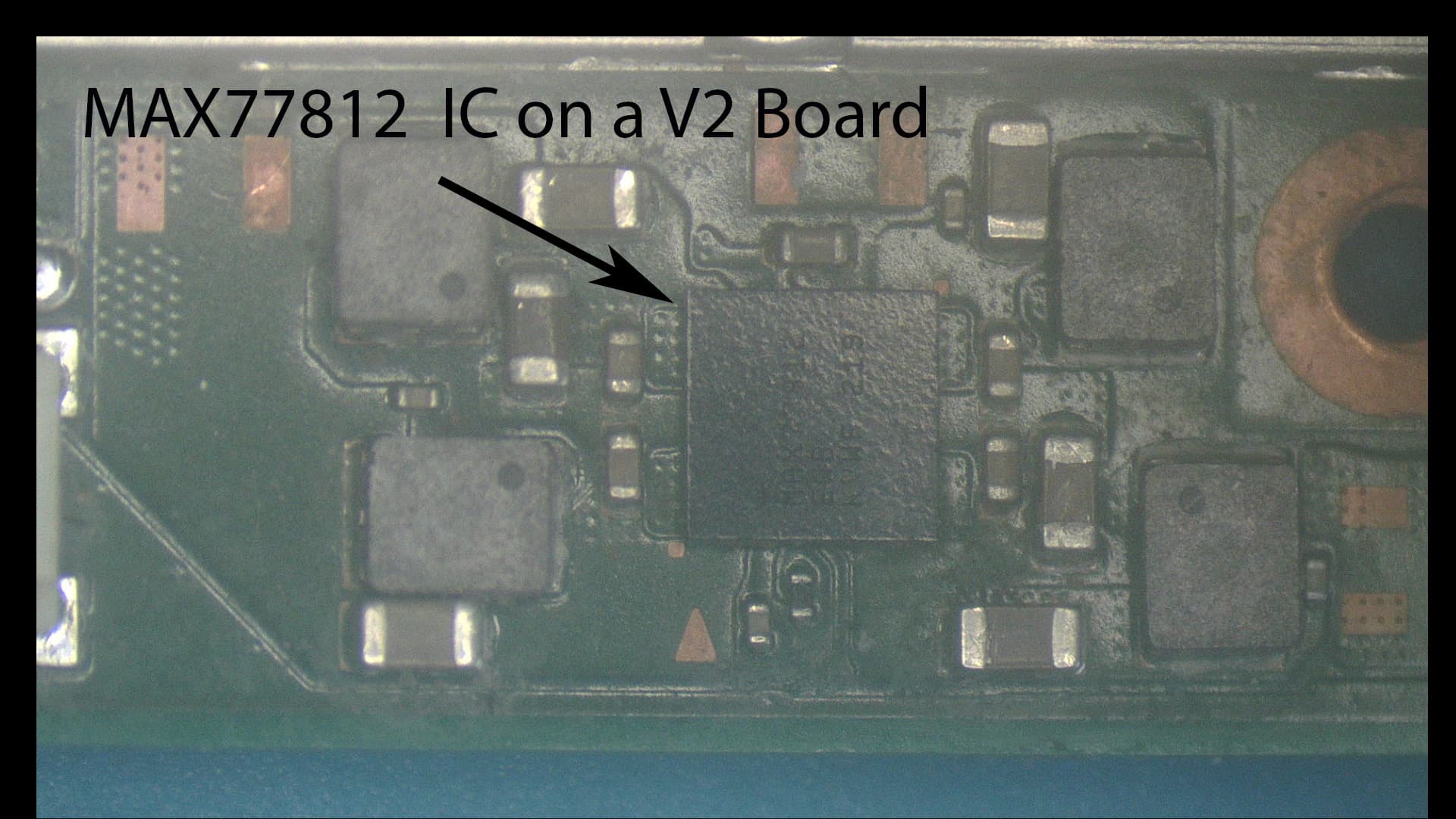

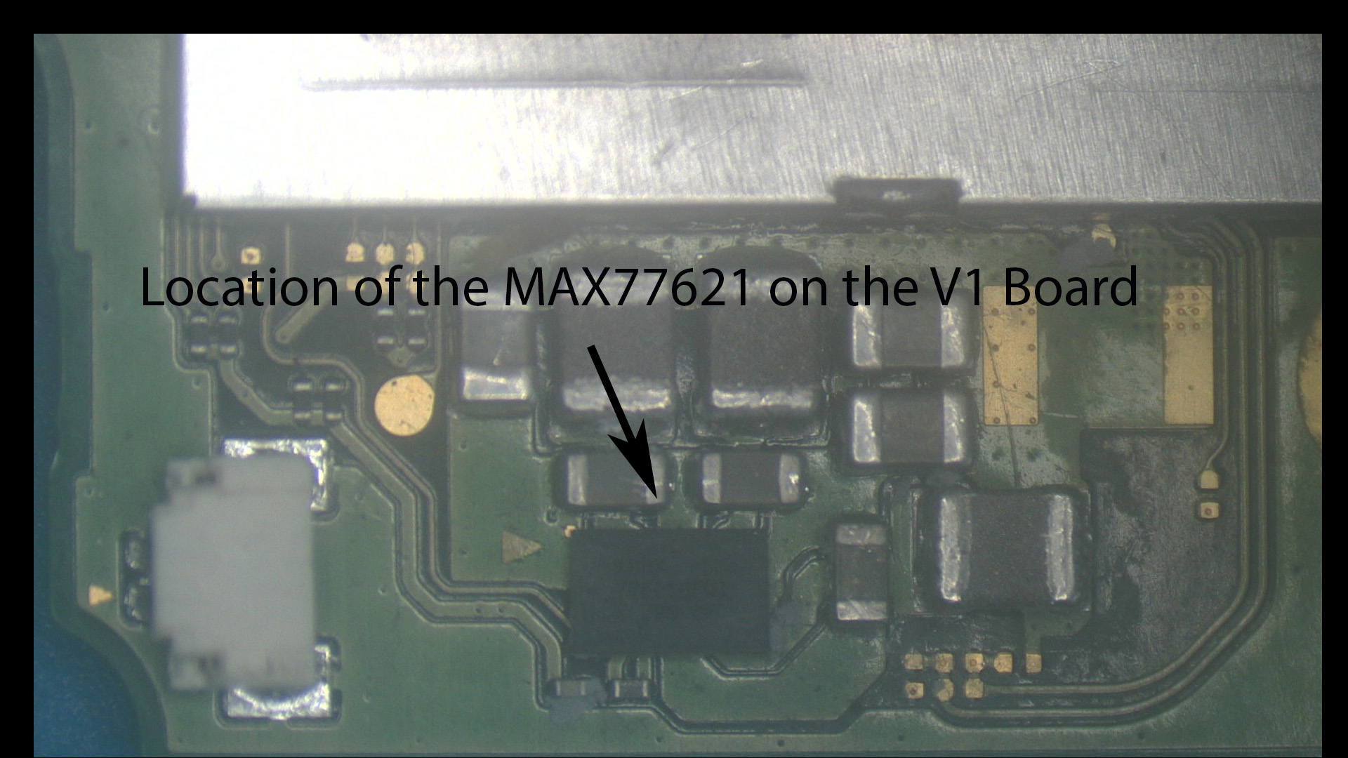

What is the funcion of the MAX77812(V2 board)and MAX77621)(V1 board) ICs
I would take they do the same fuctions
On the V1 are two separate max77621 which power different parts of the SoC.
On the V2 is one max77812 which combines the two from a V1.
