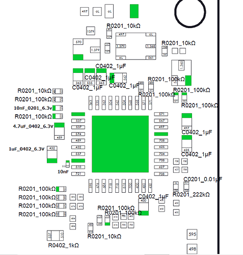

So, after a botched attempt to mod my switch I managed to remove a capacitor and loose it. Does anyone have an idea what is the value of this smd?
Unfortunately i cannot add a pic to show you. It s one of the 3 caps next to the usb c power controller chip
Credts to @Calvin
You guys are amazing.
Thank you!!
