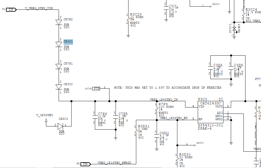

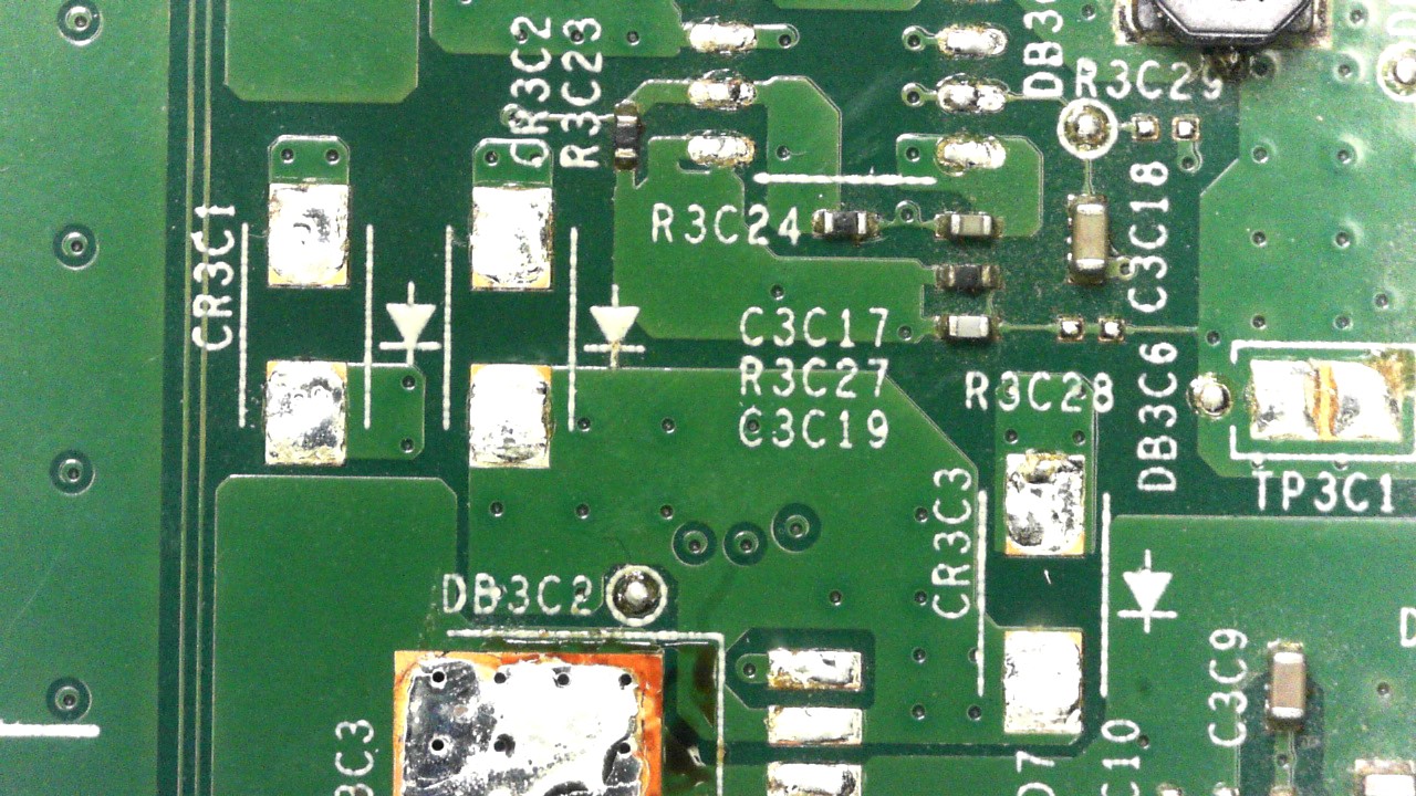

My Xbox one 1540 doesn’t turn on at all and seems to be missing cr3c1 located in C3 of the motherboard can anyone help and tell me what should be there kind regards Russell
Hi, CR1,2 and 3 are missing on my board, looks like they have never been fitted. Legend indicates diodes, type unknown.
HTH, Stan.
