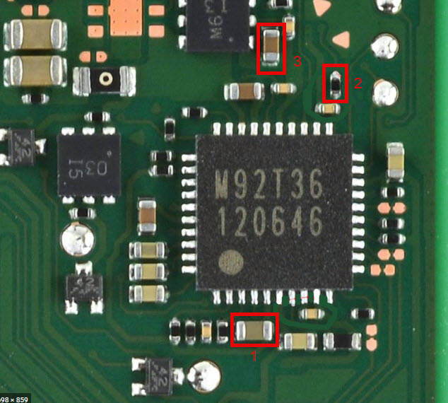

Hello! Can anyone of guys provide information about the values of the components with the RED Circle on the image attached? I was trying to replace a M92T36 chip on a Nintendo Switch Oled and accidentally removed these 3 components (please include size , already purchased the wrong ones:) )
. Thank you in advanced!

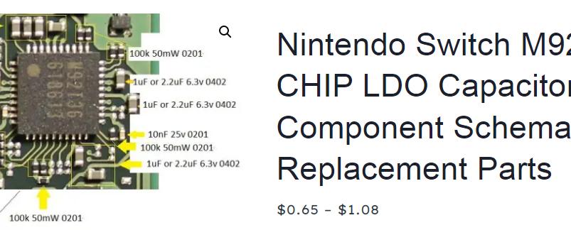

OK got you Calvin
so il take a “risk” and order this exact component you suggested for my OLED , worst case scenario i lost few $ but gain some more experience.
