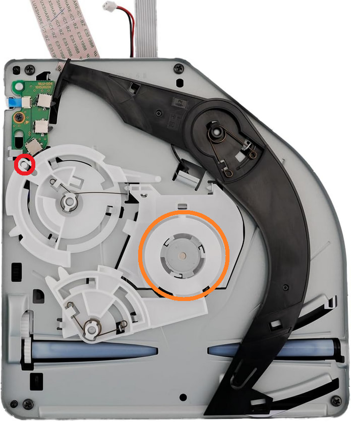

I would take the drive appart again. Check if the center part (orange) is still in place. And check if the pin (red) is in the grove of the gear wheel.
At reassamble the parts should align propperly without any forcing. If the parts are not falling in place, something is not aligned.
I’m going to open it back up here in a minute is there anything in particular I should be looking for that might be out of place? I took out and put the rollers back in, and the auto feeder seems to be working again. But the disc still goes in about 99 percent of the way and it starts spinning.
So I think it’s functioning still something is just not letting fully go in
If the disc starts spinning, everything should be fine.
Well you have my endless thanks it was the red circle
