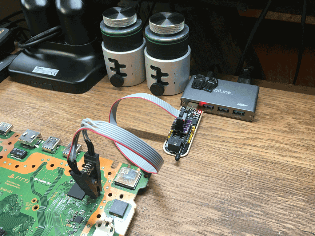

If you dump the data of the nor (bios), you can change a specific byte
(0x001C7011 = 02 (BD) / 03 (digital) ← disables BD drive)
And if you write back the dump, the console will not check for a disc drive at the update.
Wow that sounds complicated. Who do i send it to to get my situation fixed?
yes, you better off find someone do that for you, and sell the useless unmarried disc drive out for parts
how do I do that I have the bin off my bios ic
I would use:
- a programmer (for example a cheap CH341A with clamp connector adapter [Amazon.com])
 - a programmer software like NeoProgrammer [CH341A-Softwares/Programas/Windows/NeoProgrammer at main · YTEC-info/CH341A-Softwares · GitHub]
