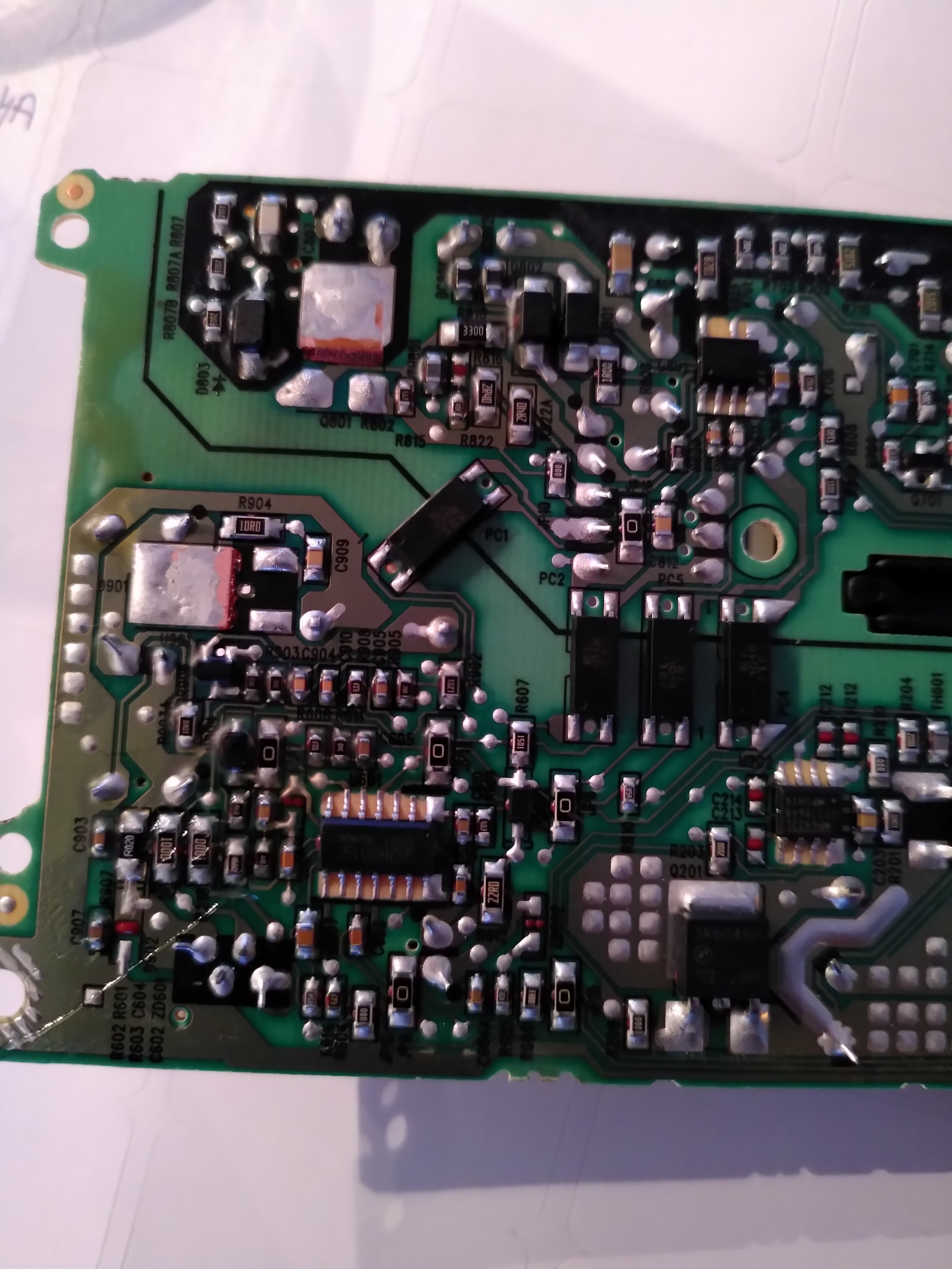

I am repairing a N16 PSU and determined that 2 mosfets and a resistor have failed.
One is marked LT 7E13 C1045 DW
The other one is marked 70SL1K4A 72035F
I can find the second one on AliExpress, but do not get a hit for the first one.
Please look at the picture for the location of both components.
Are there easy to source replacements for both components?
