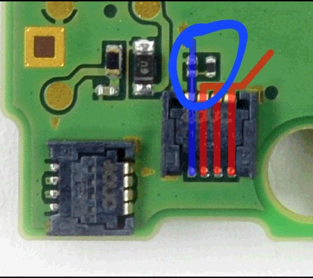

Hi, i lost a capacitor? while replacing the zif connector.
IT is the right one in the blue circle. Can someone Tell what capacitor that is?
Thanks in advance.
Thanks in advance.
Update: I bridged the 2 pads and Homebutton is working again.
I heated the board from beneath with an hot air station to replace the zif connector.
