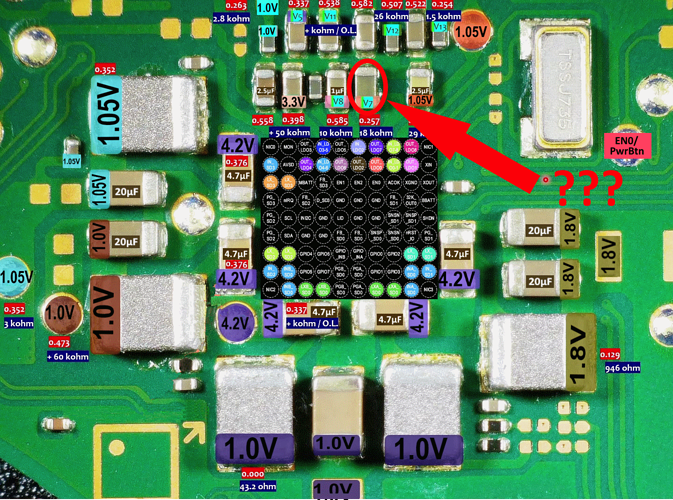

Thank you Calvin for your fast reply.
The picture of the parts I actually meant is somehow missing in my post.
So here once again:
The cap is a 0402 5 ”F
You are my hero! Thanks again!
Are you sure that this capacitor is 5 ”F ![]()
Because nearest values of E-24 series are 4,7”F and 5.1”F.
Unless it is really is a E-96 precision capacitor. The nearest value than would be 4.99”F.
Sorry, it is the direct value I measured at the desoldered cap in this spot.
A X7R has a range from +/- 10%, so it is a common 4.7 ”F cap.
Kudos for taking the trouble to desolder the capacitor for clarification. ![]()
My capacitor was somehow âblown in the windâ while desoldering the MAX77620 via heat gun. ![]()
