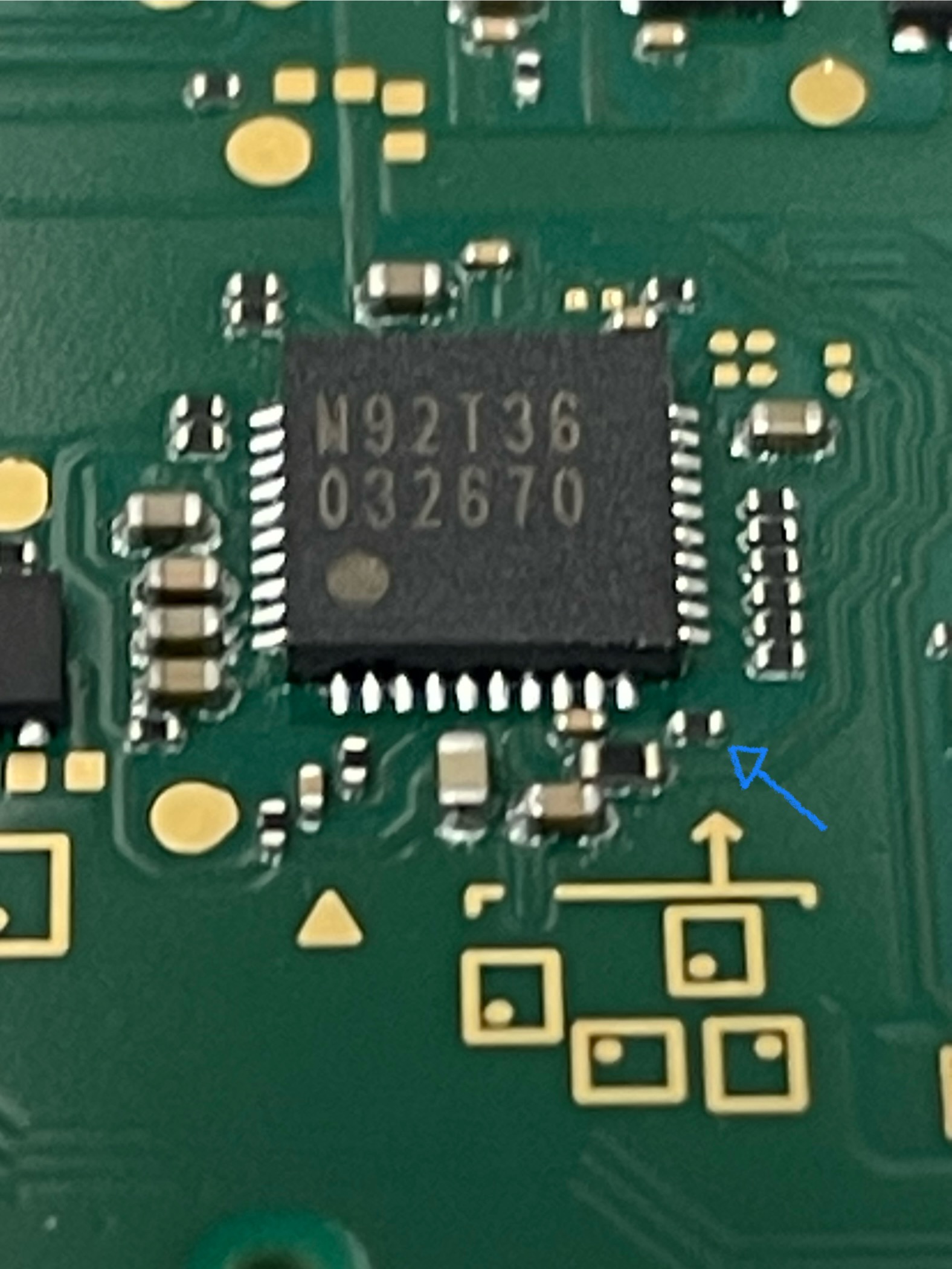

This is a Nintendo Switch Lite main board (HDH-CPU-10 side A). I blew off a very tiny resistor when replacing the M92T36 chip.
I can’t find the resistor around my work area so need to purchase a replacement. Upon searching the internet I believe the form factor is 201. However, I don’t know the resistor’s other values? Some sources say 100k 50mW while others say 10k 50mW. Anyone know?
IMG_5756|375x500
According to the datasheet for the m92t36, the resistor is a 100kOhms.
The size is a 0201.
