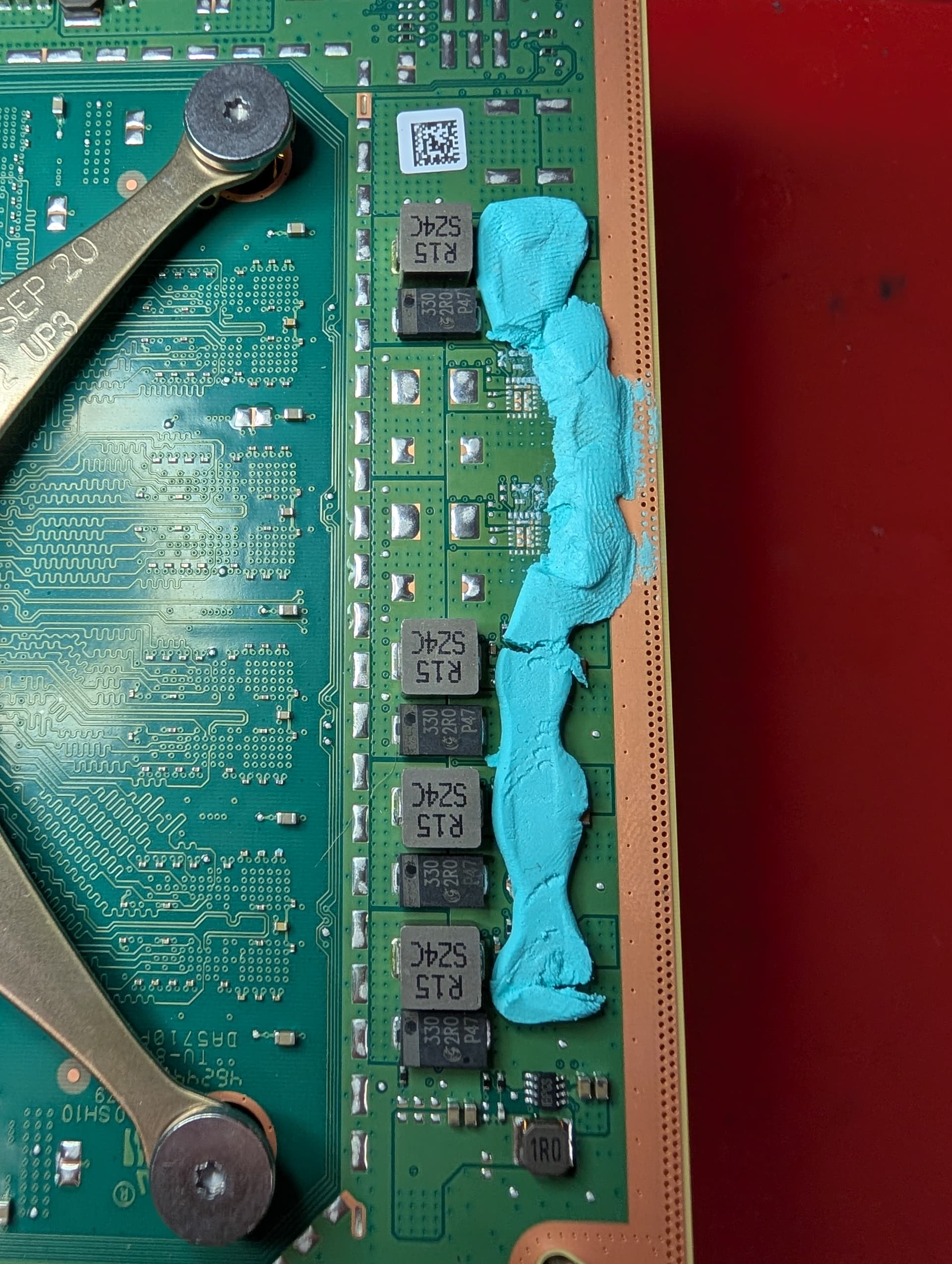

New XSX revision or was this a parts board?
So I’m working on this beep on beep off issue and I immediately notice two of the PMICs are missing. Also, I was not the one that moved the thermal puddy aside, it was already like that. Though I don’t see any signs of flux either.
I saw that the 2024 revision seems to have those two missing, but they usually don’t have pads there either. Also the other 2024 revision signs aren’t here? Board otherwise matches the old revision, plus it uses the old heatsink instead of the new heat pipe version.
