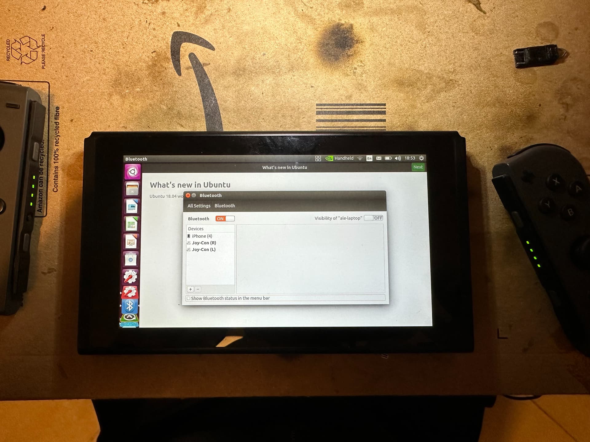

But BT isn’t able to connect neither at shorter range. Then I try again Linux, and suprise, BT can detect everything and also connect to the Joycons at shown in the image.
This point to an other Firmware issue of the replaced IC? I’m not able to find one from an other board a this moment…

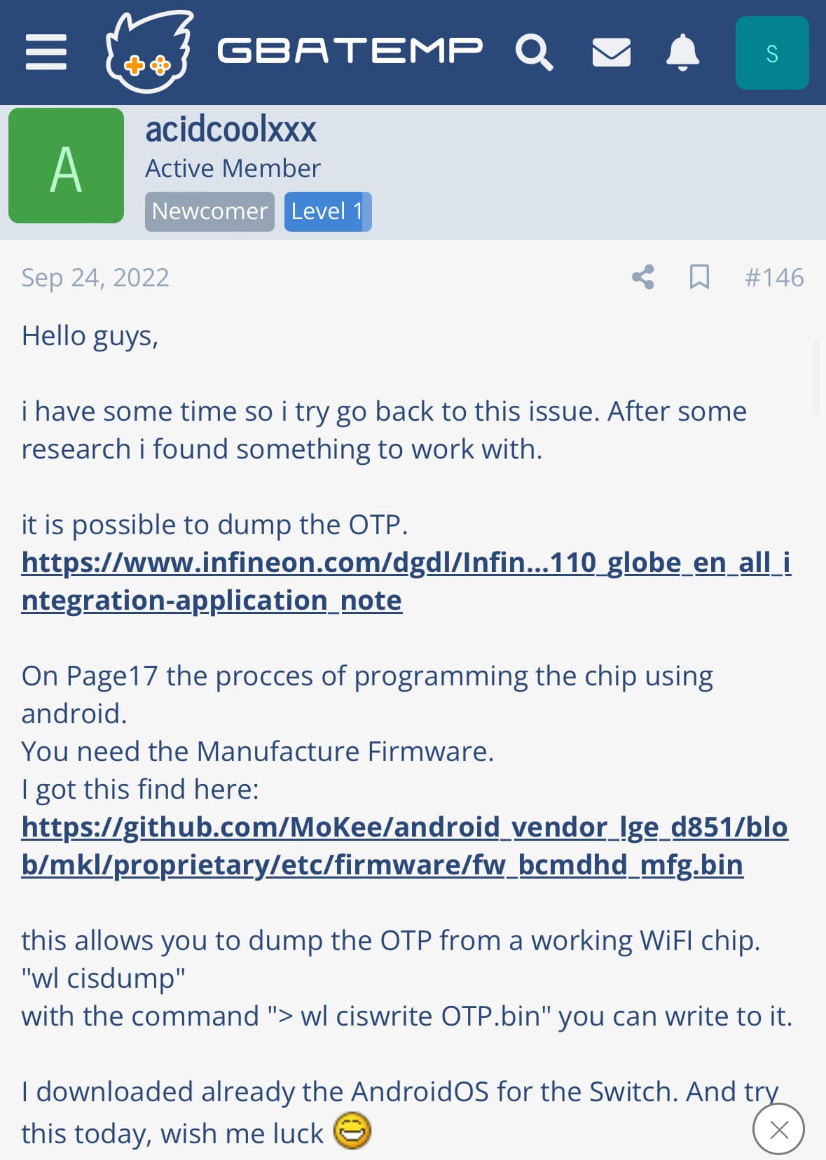

Looking on forum I found someone talking about flashing the IC using Android, unfortunately the links provided in the discussion are not working anymore :frowning:
Good stiff :+1:
Oh I see your talking aboute FW on the Wifi/BT IC itself - :thinking: Yeah it’s possible that’s the reason as several people have posted having BT issues using stock OEM IC’s … whether or not this is as a reslt of the FW on the IC I’m not really sure (or don’t remember) as I typically only use them from donors but it could well be because of that based on BT working fine for you in L4T - might be worth PMing the guy over on GBATemp and asking if he has the binary file and attempting to flash it in L4T or Android or whatnot (sorry can’t help with this as I’ve not done it myself though I wouldn’t get your hopes up as I imagine that dude would have posted if it had been successful but who knows :slight_smile: ) and failing that just getting an IC which is from a donor or from a seller who has verified it’s from a Switch donor.
