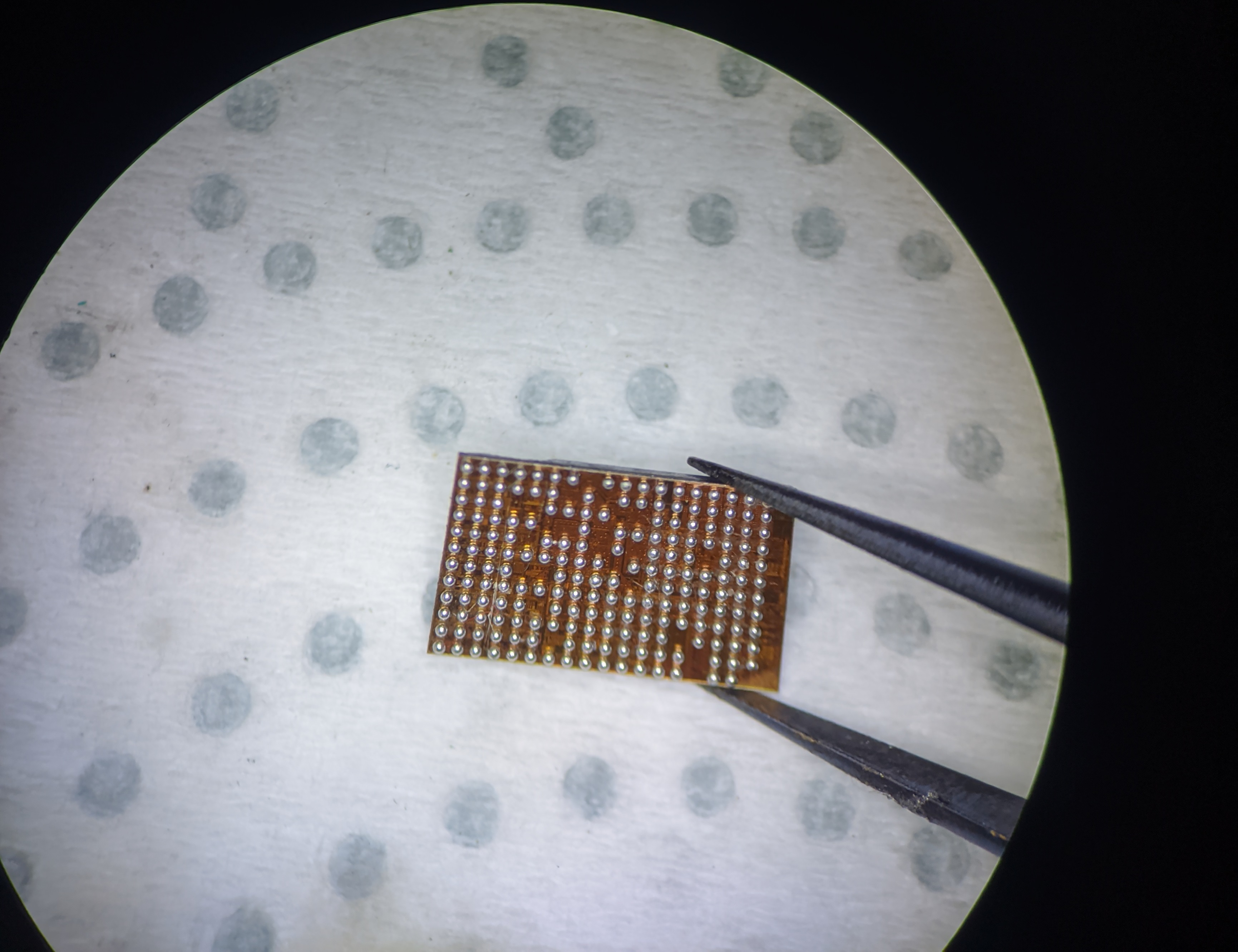

Regarding WI-FI I was in doubt, because a friend said he already bought several new ones on Aliexpress and it never worked, it only worked by removing donor plates
Yeah, it’s likely they didn’t have the correct FW flashed on them.
I typically pull them from donors as it sounds like a bit of a nightmare to try and find a seller which has pre-flashed these ICs
But thank you very much for your help, I will try to rebuild the system first, if successful I will return here
good luck :crossed_fingers:

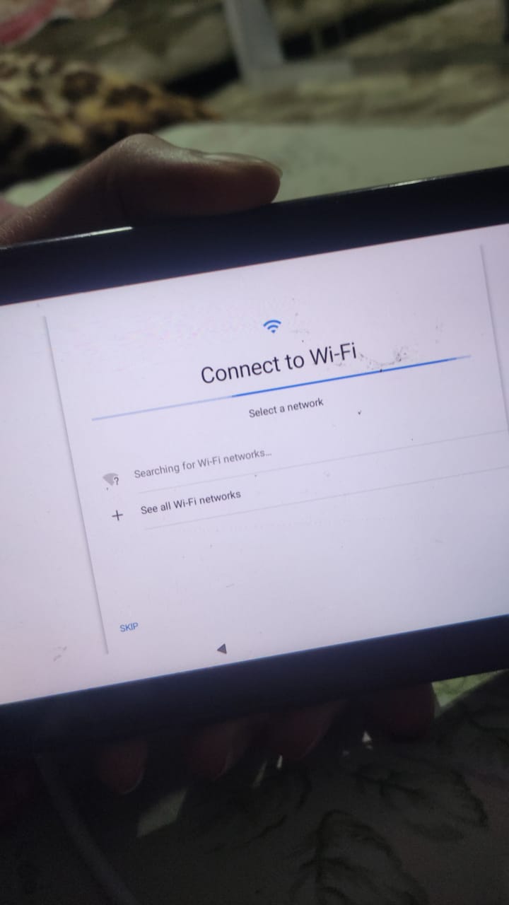

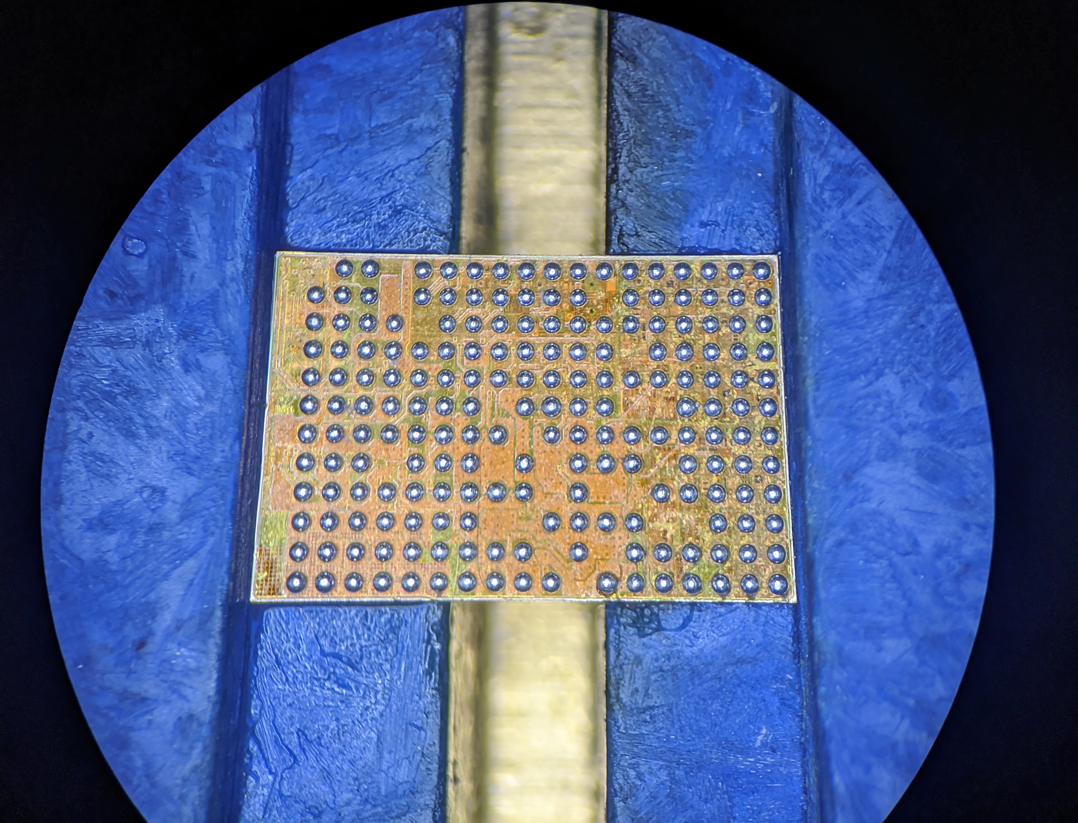

I managed to install the android system and verified that it doesn’t really find the WI-FI network, I took the IC of 2 scraps, I did the resoldering, however, without success. But thank you all!
Sorry to hear that, might be worth consdering reflowing the SoC as it’s most likely corresponding lines leading to that at fault.
