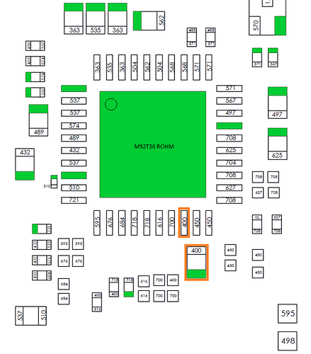

A Customer brought in a Switch with pins mangled in the port, replaced it and not the device only pulls 0.09A, no shorts around either of the chips. Also, when I plug in a charged battery the device does try to turn on and show the Nintendo logo but it gives me the error code 2102-0001 and will not fully boot. Any suggestions on what to replace or test? Thanks!

have you tested for shorts around the power chip? that might be the first place to start. It wont boot up because its not getting enough power i suspect. Have you tried a fully charged battery?

Yes, in my details I mentioned that I tested for shorts around both of the power chips, and that when plugging in a charged battery the device turns on but gives me an error.
