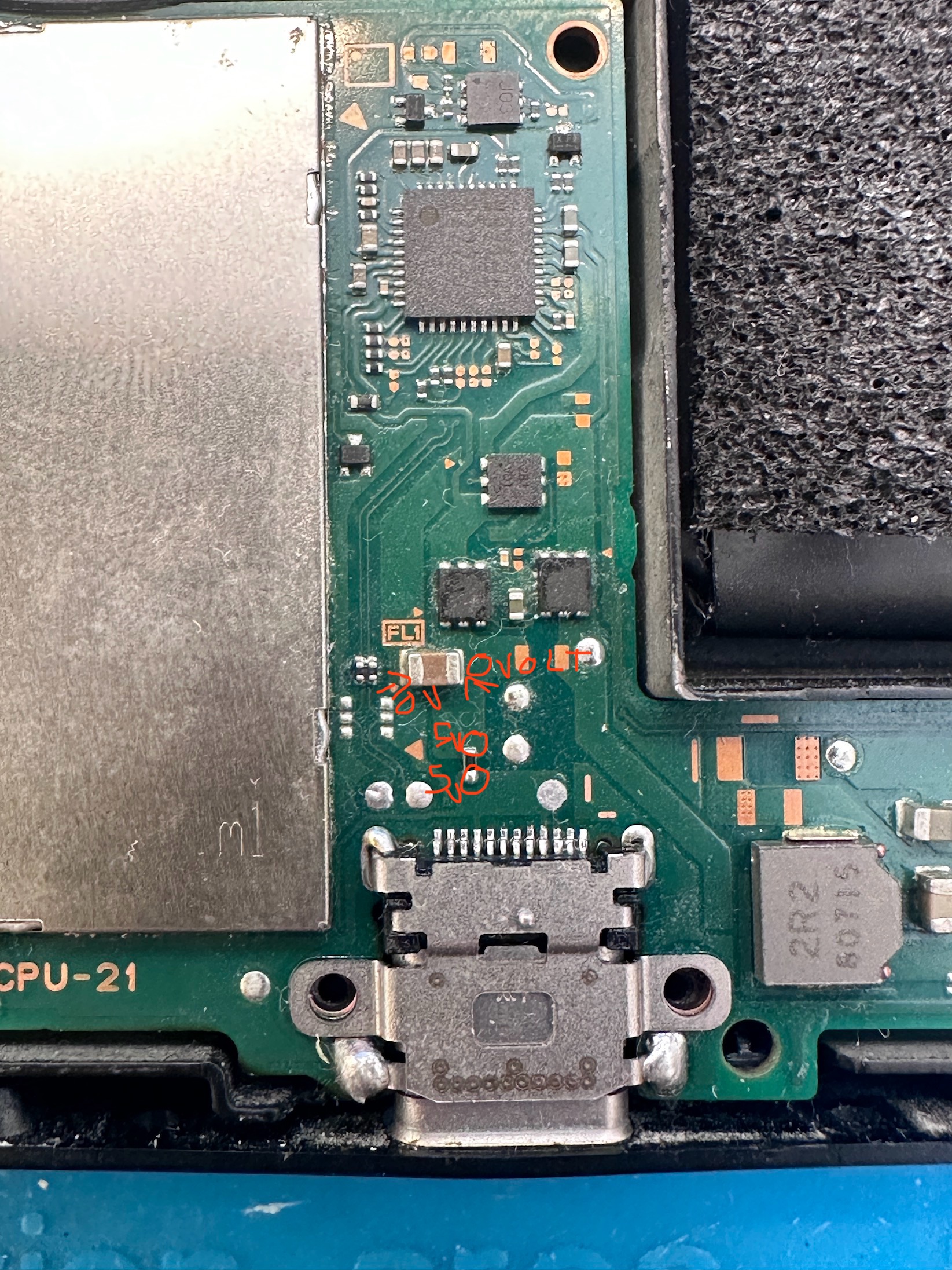

Hello I have fix my usb port on my Nintendo switch and she don’t charge , but I have 5v on usb port , 5v in fuse … and 0v other
( sorry aim French ) I poste you one pics
If you have idea
Thanks
If you have idea
Thanks
You can not have 5V on both sides of the fuse and 0V at the right side of the cap. This is one line and the right side of the cap direct attached to it.
Please check again. ![]()
When you have 5v on both sides, most of the time it is the m921 ic since it is shorted, although it does not indicate a short, the internal burning has happened to me and after having installed another one it works, I think it has a problem with the charging ic…
Also check the video IC since it maintains connectivity with the power IC.
I found on caps to m92t36 shorted , do think I need change the m92t36 ? But my switch turn on but don’t charge …
change and test voltage
I try tomorrow and I say to if it’s win or not ahah
