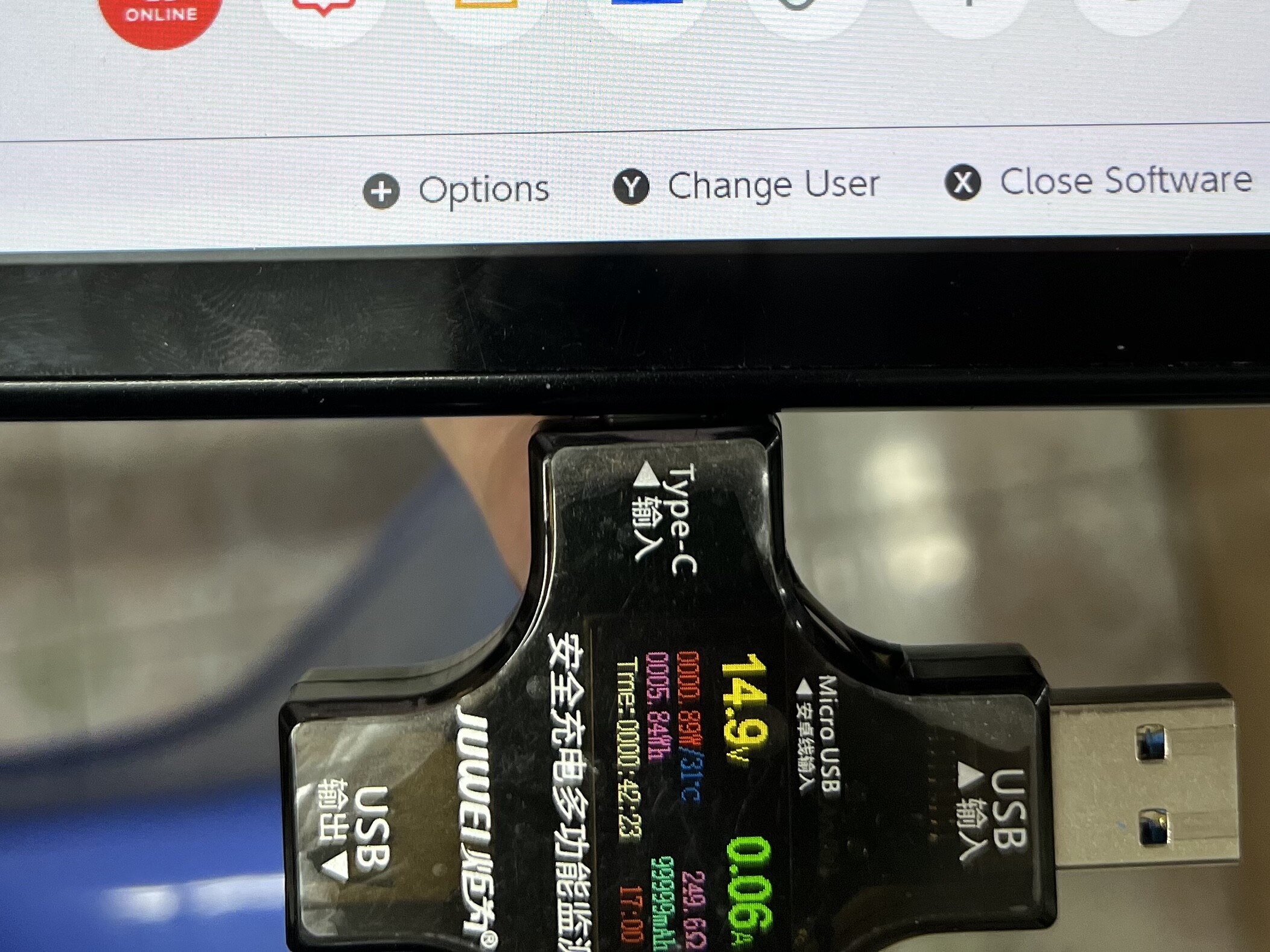

I have one Nintendo Switch Erista.Every things good except :
If the power adapter is plugged in while the screen is on, it will not charge. It show icon charging but draw 0.00A .Battery draining while plugged. (Pic1)

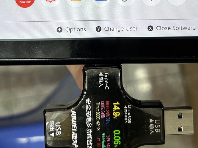

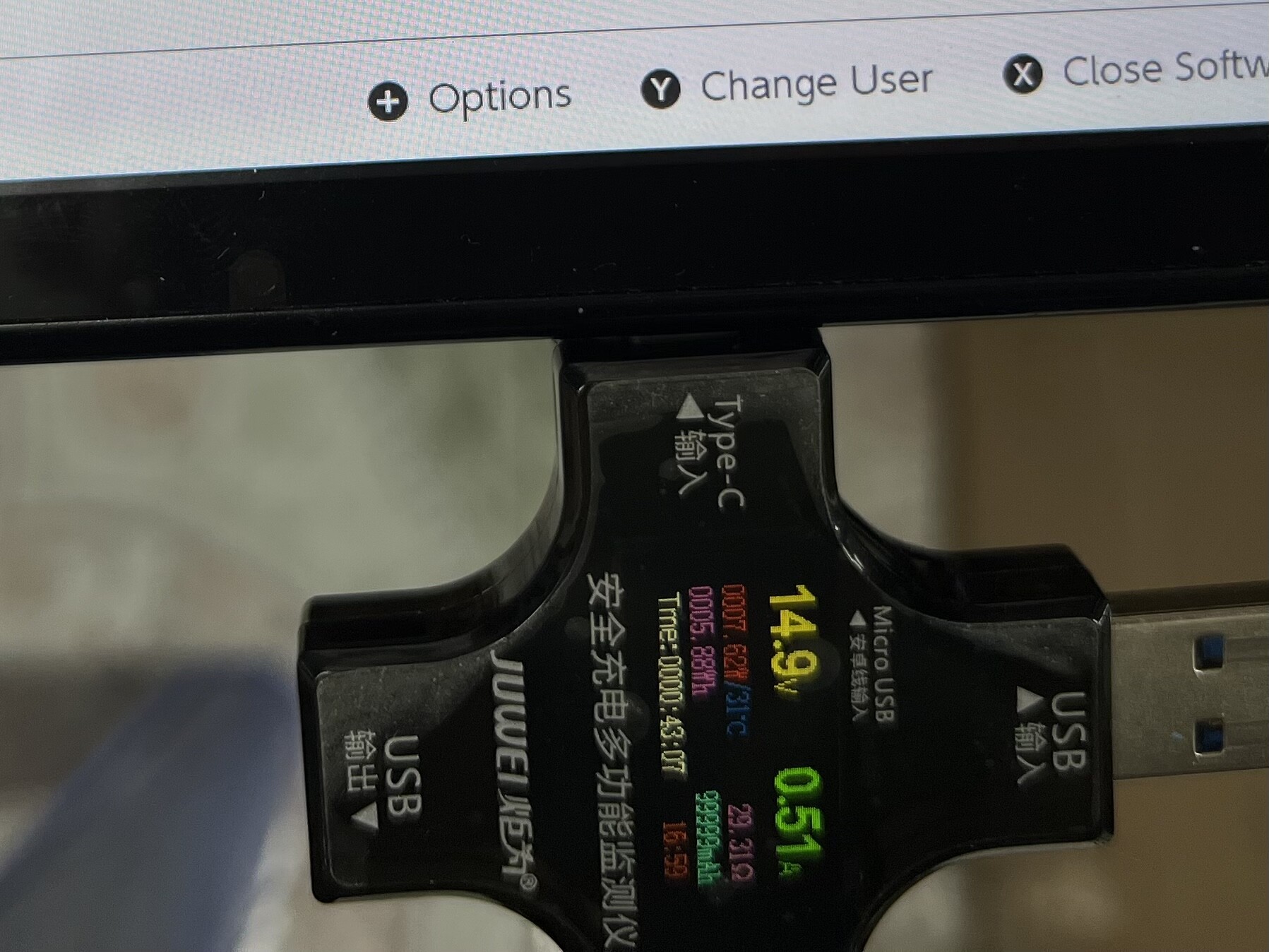

And I press the power button to put the device to sleep, everything works normally. Then turn screen on, it still charges normally. (Pic2)
