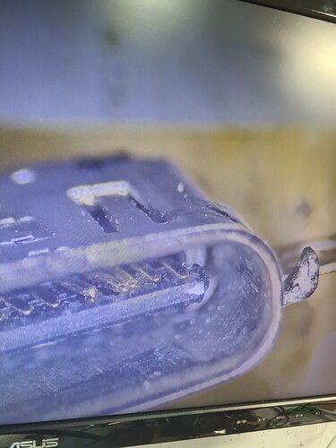

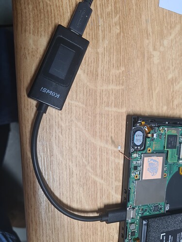

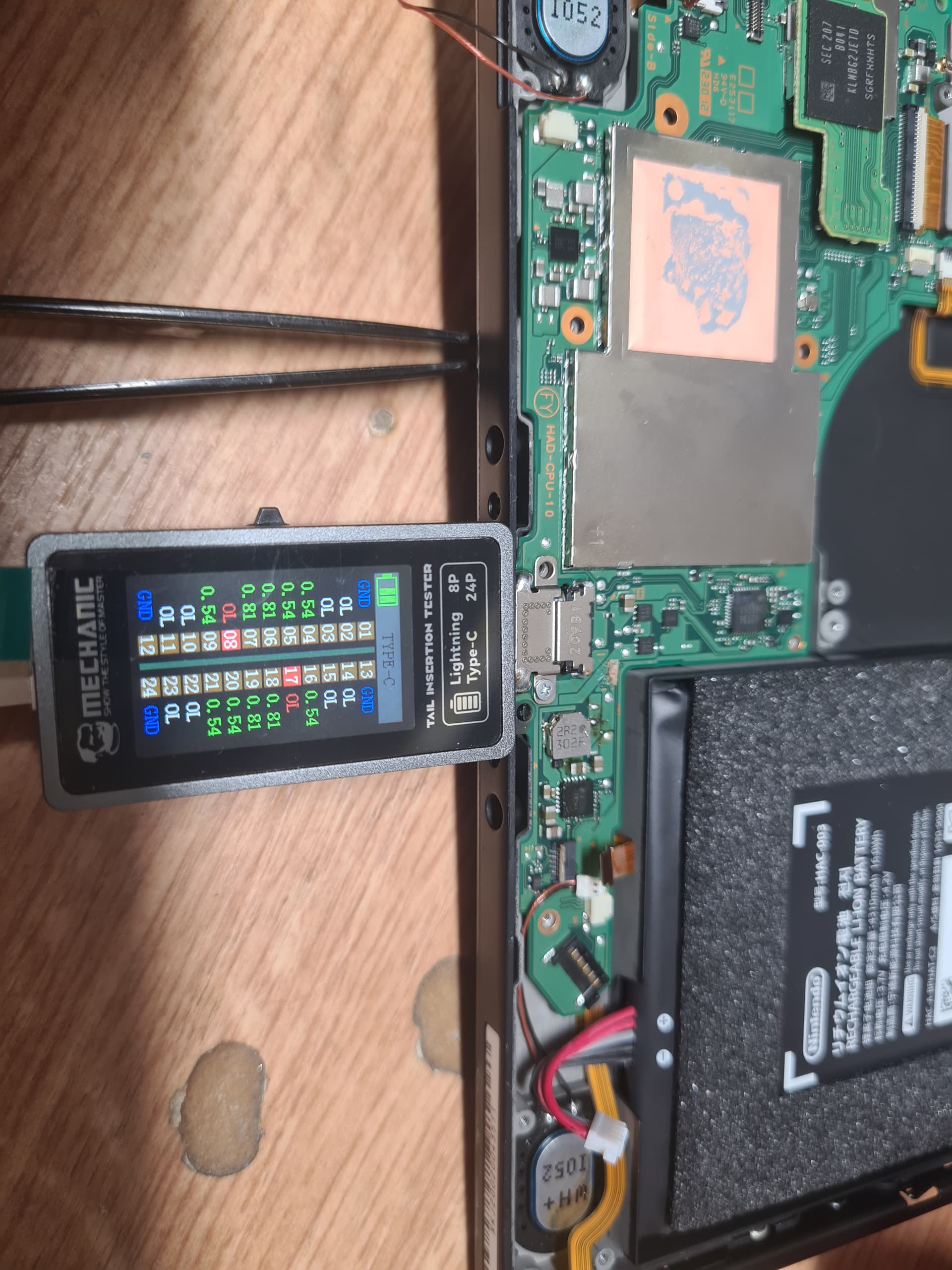

This switch had a bend pin, waterdamage indicator was triggered, but no corrosion whatsoever and a short on VSYS. Replaced the usb port and resolved the short by replacing a cap next to the alc audio ic. now when i check with mechanic tail tester it shows that pin 08 and pin 17 are open line. when i plug in a amp meter the amp meter stays of. i already replaced m92t and bq ic but the issue still remains. the switch itself does start and is usable with a charged battery. does someone know where line 08 and 17 goes to?
thx!
I’m not sure where the tester is setting pin 1. It could be CC1 and CC2 (M92T36) or SBU1 and SBU2 (PI3USB).
check the piusb 1st filter
