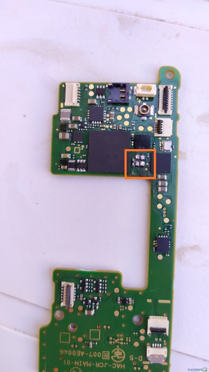

I have a Joy-Con that doesn’t work. A chip is missing as shown. Can anyone identify? Or indicate an equivalent component? I had to look at the other Joy-Con and I think I identified it but I can’t find it.

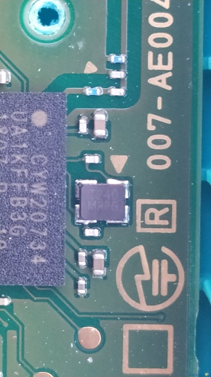

A friend also send a picture of is Joy-Con.
Part Reference: D247B
I appreciate the help.
Thats a crystal oscillator
TXC (2.5 x 2.0 x 0.75 mm 7S Series) 24MHZ
(7M-24.000MAHE-T should work)
