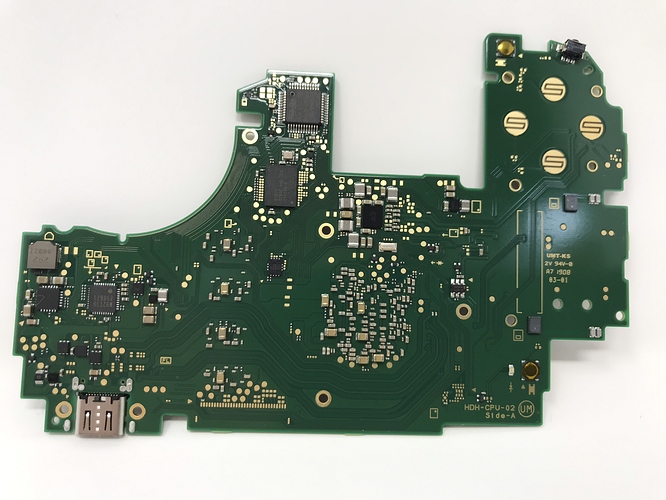

What did Nintendo do so the Switch Lite wouldn’t output HDMI using the dock?
Looks like they totally removed a bunch of the circuitry that would make that work. There’s no video chip on the board anywhere
Anyway to add one from a donor Switch?

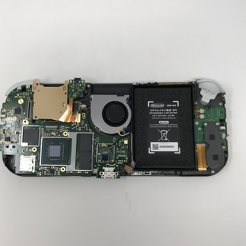

Is the battery glued in like the normal Switch? It always makes me cringe watching you take the batteries out, i always think they are going to burst into flames.

No…the circuitry is not even there
Yes, it’s glued in. I haven’t even started it up yet! It’s still apart from the teardown video!

I noticed something interesting: there’re 2 data lines near top right corner of USB connector without inductors (side A). On FCC teardown pictures, they are populated…
Also, what’s that IC on top center on A side? It doesn’t seem to have counterpart on std switch. I’m not able to read label…
What’s the part number the m92t36 chip on the swtch
@Letchworthelectronic That’s the charge chip. Common failure point. M92T36 is the part number

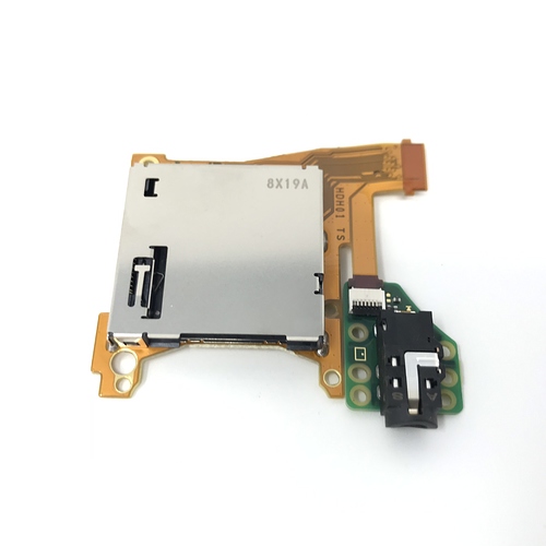

I need a game card reader slot for nintendo switch lite yellow. Nomber model: 9218B, HDH-01 TS.
It likes the IMG_3788.jpeg picture.
Where can i buy one?
